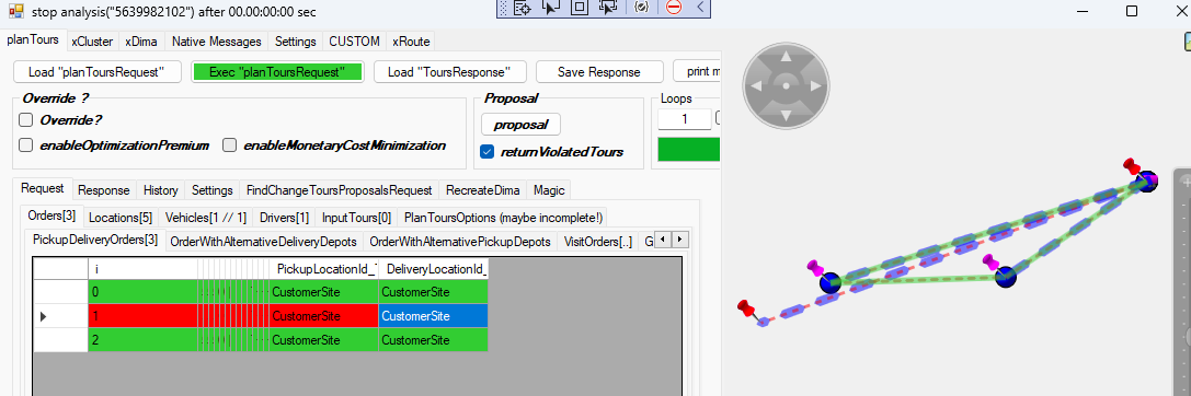

Well, I anticipate you already found the relevant hint: the object you call "depot" is in fact modelled as CustomerSite:
  • top right: the requests's global "pickup" location
  • Red pins / red dashed line: impossible sequence because of the PositionInTrip.FIRSTCUSTOMERSTOP
In the list of the three orders the red one is the unplannable one: all locations are modelled as CustomerSite and as the DeliveryLocation of the red order is by design supposed to be visited AFTER it's PickupLocation it is impossible to satisfy this constraint.
