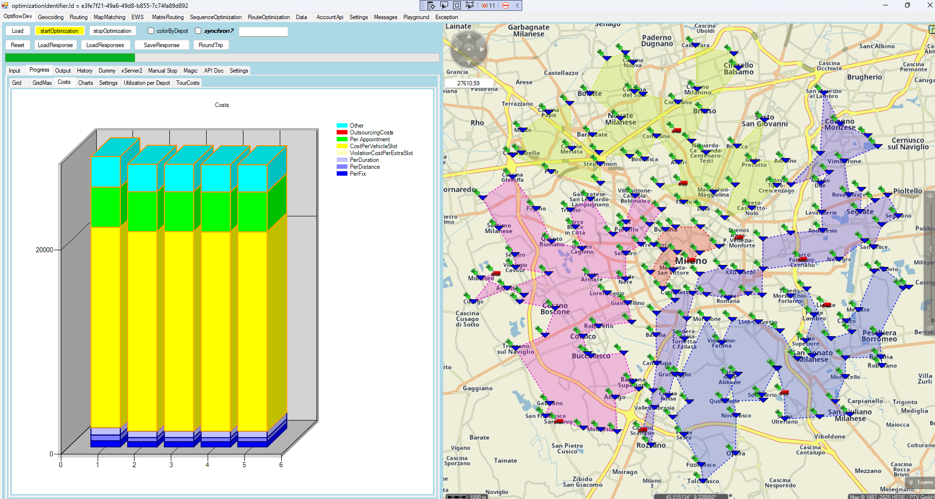

Optiflow APOI within Developer does even provide the full result structure with each and every status request. Each column in the chart reflects a tour plan... supersexy!

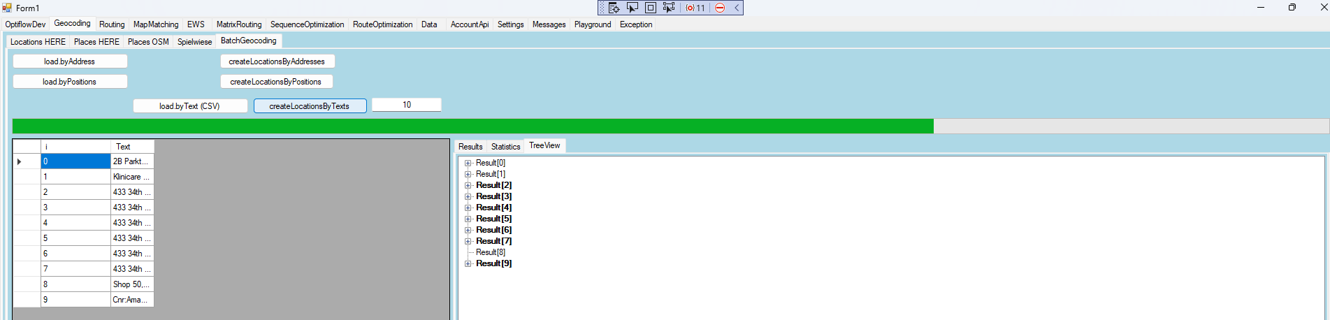

In this example I visualize the progress of a 10-addresses batch geocoding
