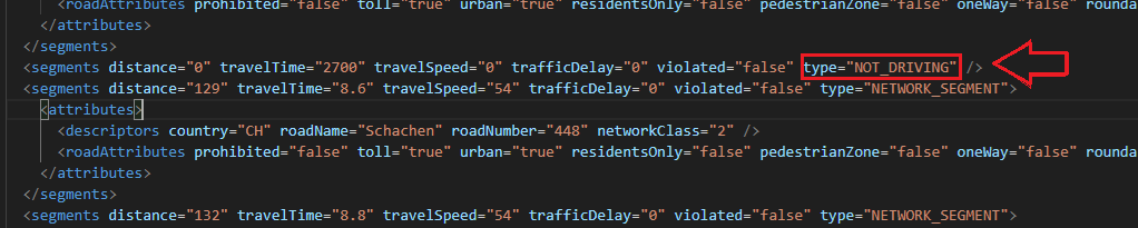

The only place in the xRoute response that I`ve noticed something related to the break is in the segments:

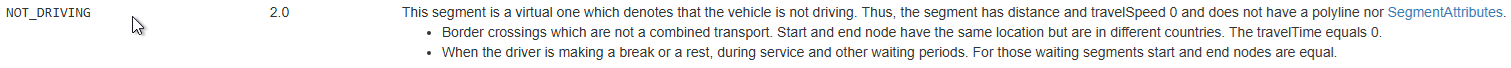

which according to the Segment type documentation it can represent a driver break.
After I removed the ConfigurableWorkingHoursPreset option, this segment type was removed as well proving that it was added by it.

The observation that there is a NOT_DRIVING segment with the duration of the break as travel time is correct. If also the nodes are requested in the result fields, for each event we return also the node index which can be used to identify the corresponding node (and hence also the segment).
