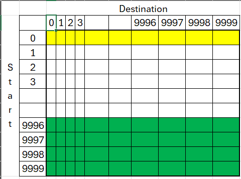

Well : nobody said, that you have to consume the data in a single transaction. Just cut that thing into pieces!
Imagine a (3'000)² matrix created on the server via a single, regular com.ptvgroup.xserver.xdima.CreateDistanceMatrixRequest (based on HPR)
Makes sense to gather the content row by row (a start to all of it's destinations)
