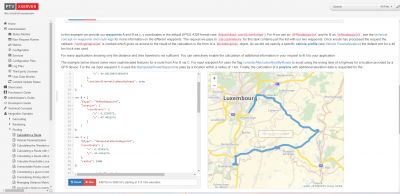

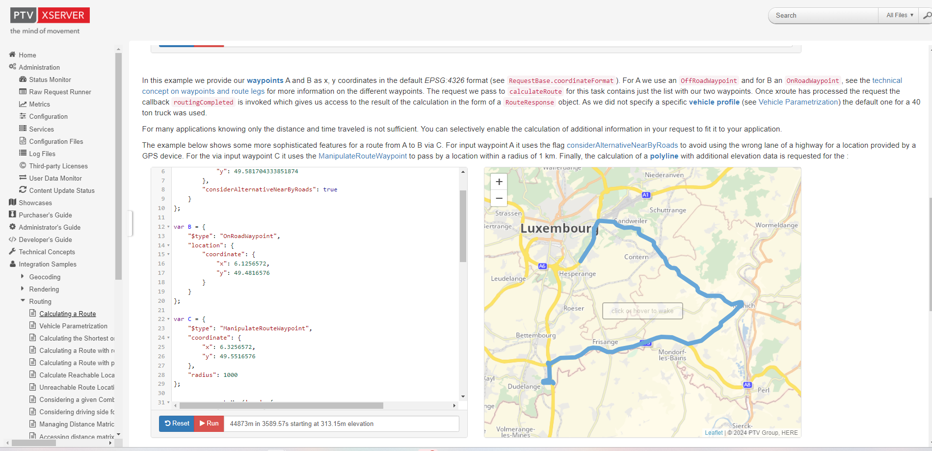

one of my partners is a fan of the built-in integration samples available through the standard xServer2. Now he wants to know how what surrounding, "invisible" code he needs to wrap around the given code blocks to make them work outside the xServer - also in combination with PTV xServer Internet 2.
Can we get some guidance?
Sample "Calculating A Route"
PS: as I am not developing in JavaScript by myself, I assume he needs some
  • include statements
  • Token handling
