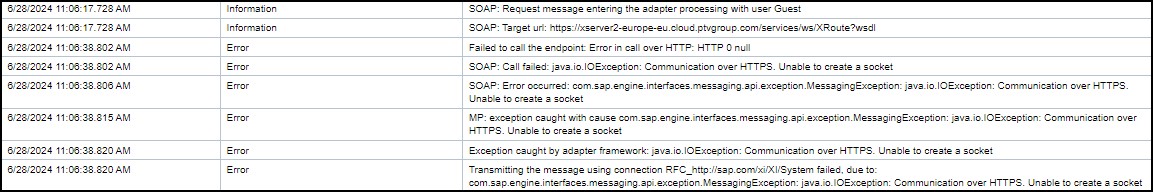

Well, as announced : we recently disabled TLS 1.0/1.1 on 25.6.2024 on PTV xServer2 production and unfortunately some clients seem to run into errors such as
What you have to check then is
  • Does your client host have access to the following URL via a regular browser? https://xserver2.cloud.ptvgroup.com/ - if not, then we have a generic issue between the host machine and the destination URL
  • Now the more tricky part iy probably how to check the access of a specific application. Honestly spoken: I am not an SAP guy and therefore I need the community to contribute in a way Mister X and Michael W. did above: Who can guide SAP administrators in this topic?
