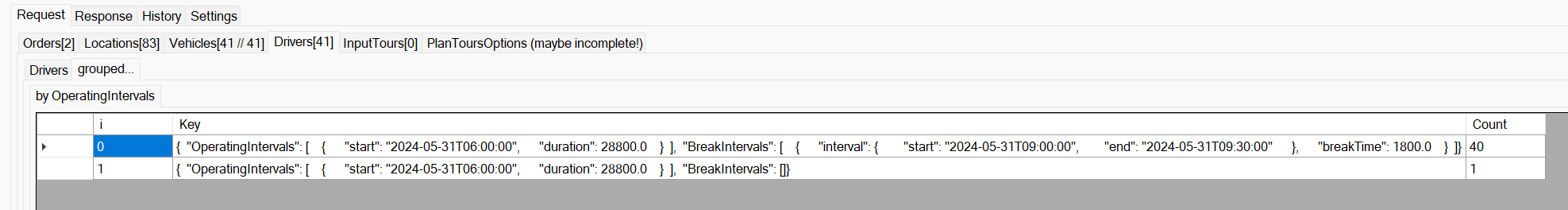

For some reason all but one driver have break rules.
In this case the services (each last 3 hours) are not possible within the given constraints (opening times of the location, driving time from/to depot...)
So this is why one order is scheduled and the other one has no option to be attached.
By duplicating the "driver without breaks" I managed to schedule the order.

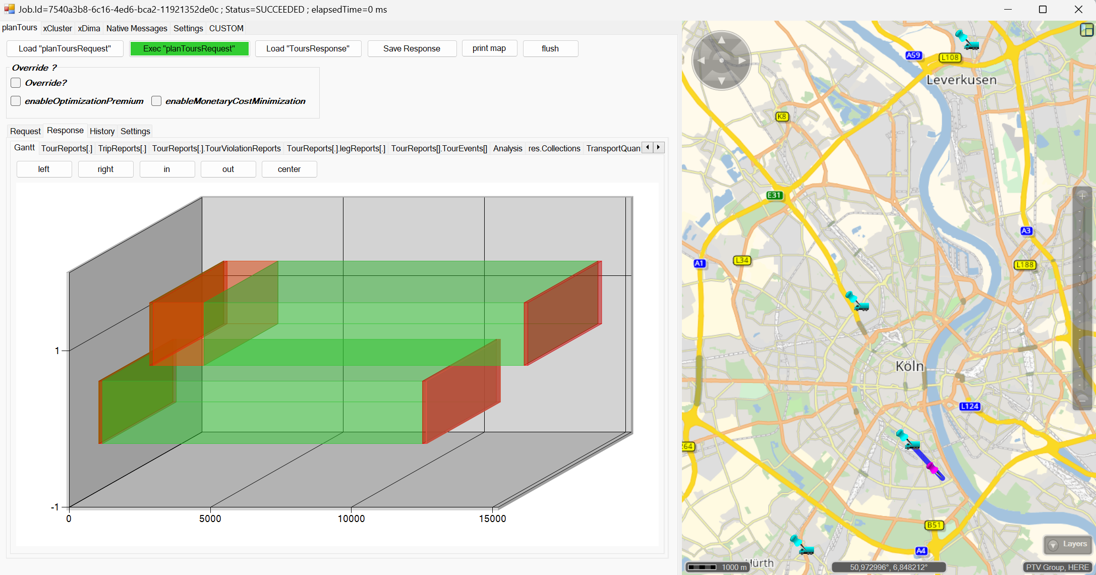

I made further tests:
The attached Gantt shows
  • The two tours I created successfully with a first run and TWO vehicles without break intervals.
  • Then I evaluated the output plan but also applied the break rules for one of the vehicles
  • This led to an invalid input plan as expected.
