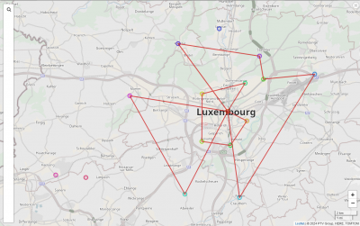

Hello, is there a way to plan together both orders belonging to a group and orders without a group?
I've modified the showcase example (attached) and removed/emptied groupIds from some of the orders and from vehicles. My expectation was that those orders would be picked up by the closest tour but they end up notPlanned and notPlannable.
Regards,
Gregor
orderGroupConsideration.zip
(1.22 KiB) Downloaded 160 times

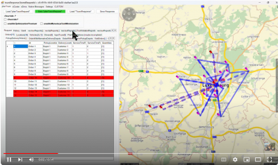

you probably spotted it:
The technical concept "Order Groups" mentions:
If order groups have to be considered, that is, if "one group per trip" is chosen, then orders without a specified order group will remain unplanned.
I will forward this topic to DEV. Little YT video
Spontaneous idea - meanwhile already confirmed by Frank R. (DEV):
  • plan the groups
  • use the output plan with a fixation, remove the "one group per trip"
  • and try to add the unscheduled groupless ones to the plan
