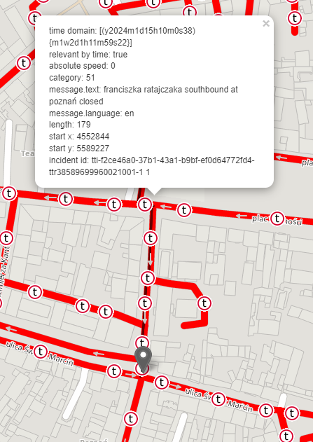

We can confirm the high runtime of the request in the direction from Hamburg to Poznan. The coordinate in Poznan is at a road with two closures:
  • The first is a truck restriction for vehicles above 3.5 tonnes of weight which is always valid.
  • The second is a traffic incident which says that there is a road closure until March 1st, 2024.
the inner city of Poznan in tewrms of "PTV_TruckAttributes"
Why does this relate to the runtime?
The route is violated because of these two restrictions because actually the destination cannot be reached. When routing from Poznan to Hamburg, then the algorithm already knows that it departs from a violated start and the violations do not lead to a longer runtime. It is already violated, so there is no need to try to find a way without violations.
However, in the other direction, that means routing from Hamburg to Poznan, the route start in Hamburg is not violated and hence when reaching Poznan the algorithm tries to find a way with the least amount of violations possible. This is the reason for the long runtime. Actually, there is some special handling in place to avoid such a big search space, because regardless of this location being start or destination, the algorithm knows which coordinates are violated and can therefore adapts its behaviour.
So this is a really unfortunate combination of data and algorithm. There is a threshold on the remaining duration of the road closures in PTV_TrafficIncidents for when it is either treated as a violation or the remaining duration is added to the traveltime. I suspect in this case the latter to be the case. This increases the search space a lot because with a driving time of almost 2 weeks you can drive very far.
Furthermore, the request makes use of PTV_TruckSpeedPatterns in combination with time consideration mode ExactTimeConsiderationAtStart. This means, that the speed information on a street is evaluated exactly for that moment when the vehicle would be there. This of course is the most precise but also the most expensive way. And unfortunately with increasing search space, this becomes even more expensive.
