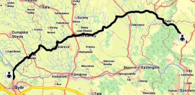

In the example we are planning between the following 2 points: 47.946111, 19.146665 – HU and 47.729792, 17.636301 – HU

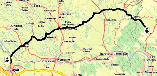

With our current profile, setting and map data, xRoute calculates the following road:
The route is incorrect and violates the transit road rules! All of these roads are forbiden to use IN TRANSIT drive in Slovenia. That kind of limitation is the same in any other countries in europe.
The right sollution could be one of the following: We use roads only in Hungary because thats the destination/origin, or we could use Slovenian roads BUT ONLY the transit ones.
We can not limit the countries involved in planning to Hungary in our case, because the valid transit route in Slovenia might be better compared to the hungarian route.
Could you please help us how can we achieve that desired behaviour?

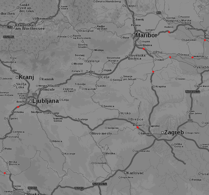

first feedback from DATA department is: The data retrieved from the providers do not contain such PreferredRoutes for Slowenia by now.
E.g. HERE (2015.Q2) provides only 6km of PreferredRoutes for whole Slowenia. We still discuss about how to approach this in your context. As soon as I have new input --> I'll answer.

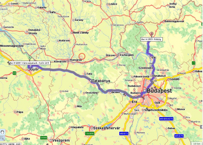

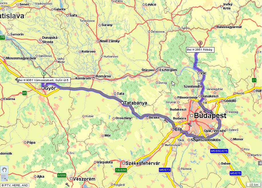

Our colleagues tried to reproduce your routing geometry but it always uses hungarian roads. Best regards Bernd
PS: did you use some more avoid/malus values?
meanwhile I received further info from my colleagues:
How about using the ExceptionPath mechanism to assign a negative value (e.g. -75 = a preference) to those preferred routes?
Strange thing:
