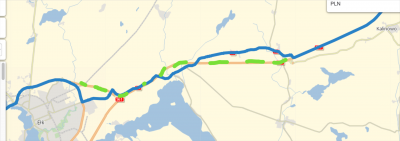

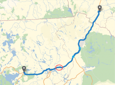

There is a route from Kalvarija LT to Orzysz PL and it seems a part of route S61 PTV does not "see" and redirects to the old one. Truck should stay on S61 (marked in green).
It seems PTV doesn't see the new road and directs through an old one

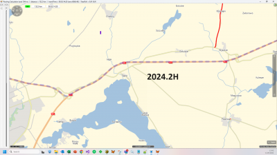

Feedback from Thorsten:
The 2024.2H map is supposed to be available march 2024.If you refer to the 2024.1H map then the data has been provided through HERE and the highway is flagged as "under construction".
In the 2024.2H map the route takes the highway.
