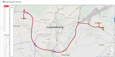

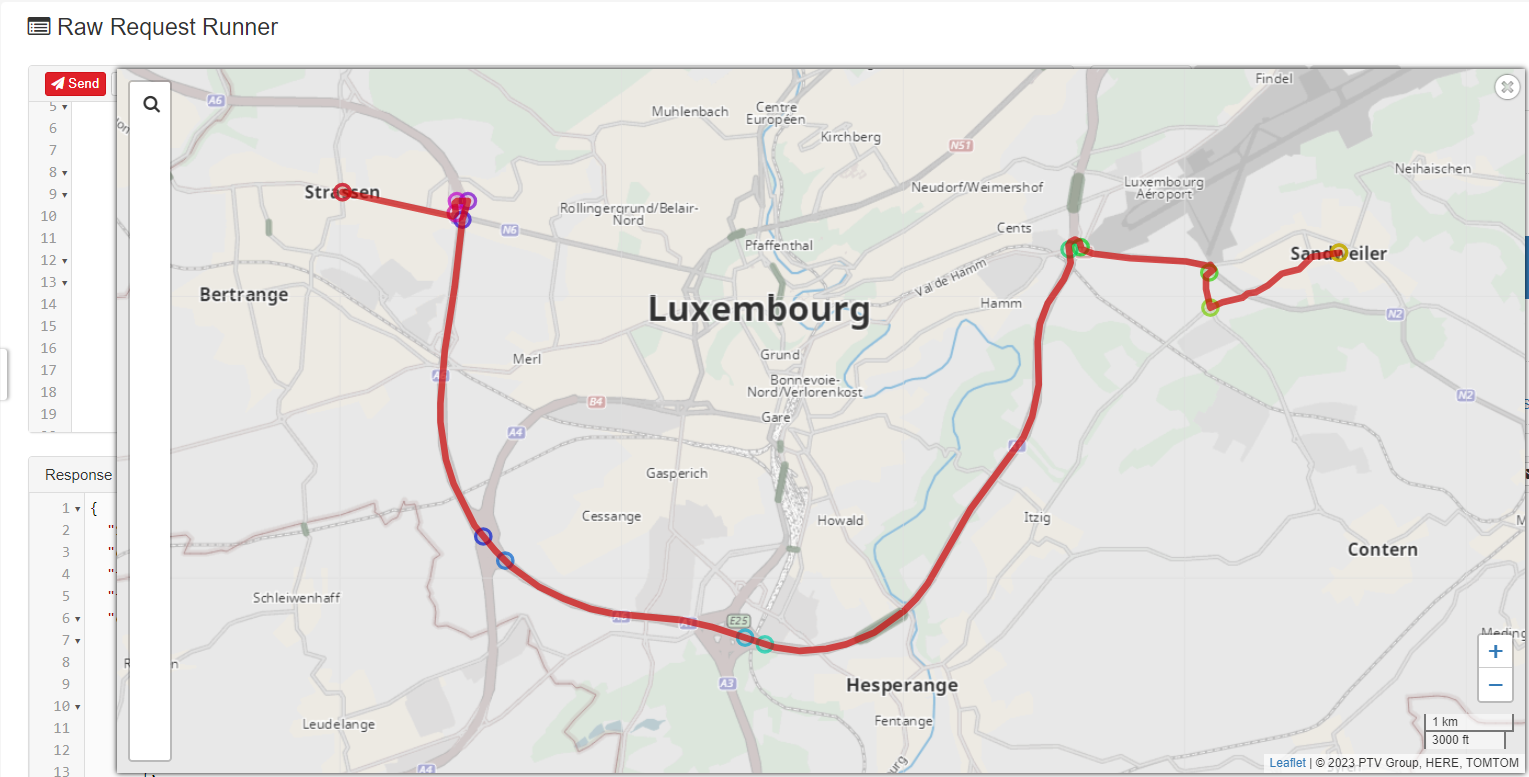

rule in LU,DE enabled - detours

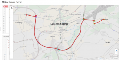

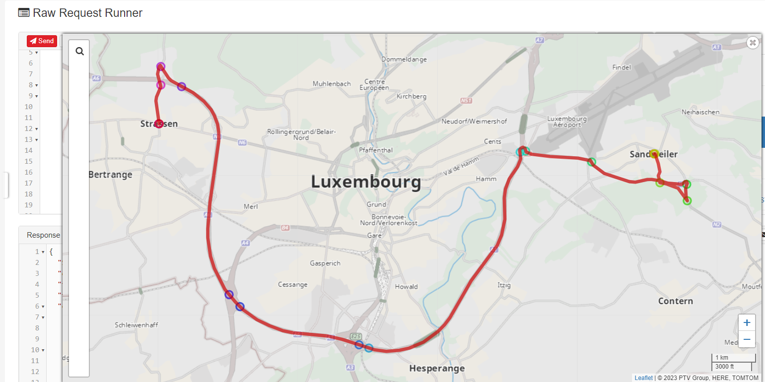

rule in LU,DE disabled  - no detours
