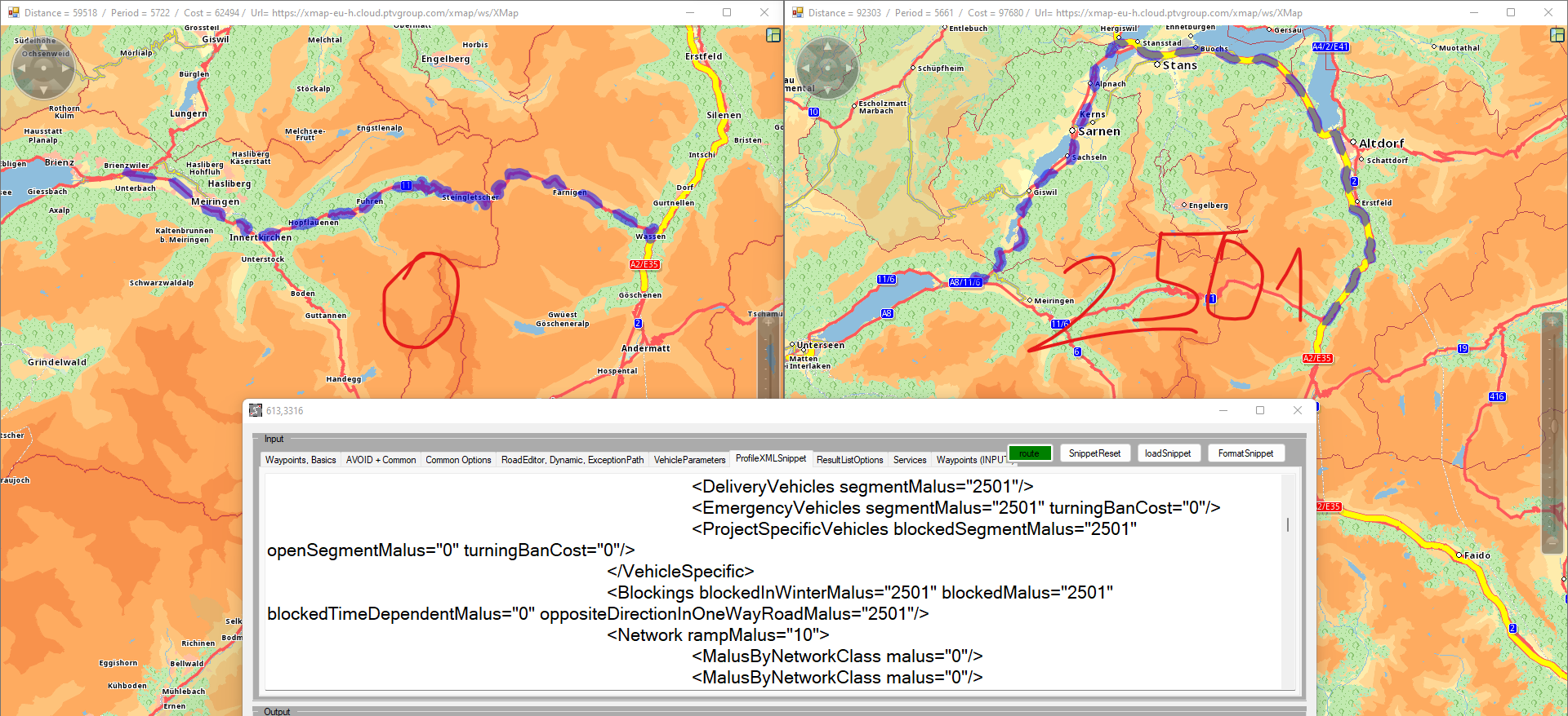

I've been asked whether and how PTV routing can consider the information that some roads are blocked in winter time (e.g. in the swiss alps).
Well, here's some relevant info:
  • technically spoken there's a segment attribute "blocked in winter" (unfortunately I don't know how to visualize such segments at the moment)
  • in xroute 1 it is possible to define a malus value for such segments. Of course 2501 means "forbidden". The disadvantage of this approach is that the user has to decide whether it is winter or not ;-)

    comparison of the malus values :<br />0 = allowed (without any special treatment of the relevant segments)<br />2501 = special segments are forbidden
  • As of today (22.8.2022) this feature is not available in xRoute2 and Developer.
