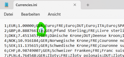

Here's what this is about:
In his case there was an error in the file Currencies.ini in the map. In the entry for GBP there is a wrong character ">" behind the exchange rate.
Please remove the character and restart the server.
This should work fine then... If not: create a helpdesk ticket
