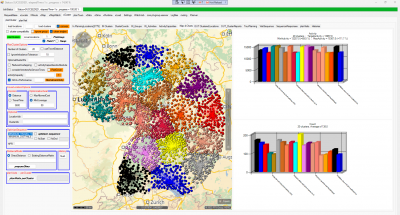

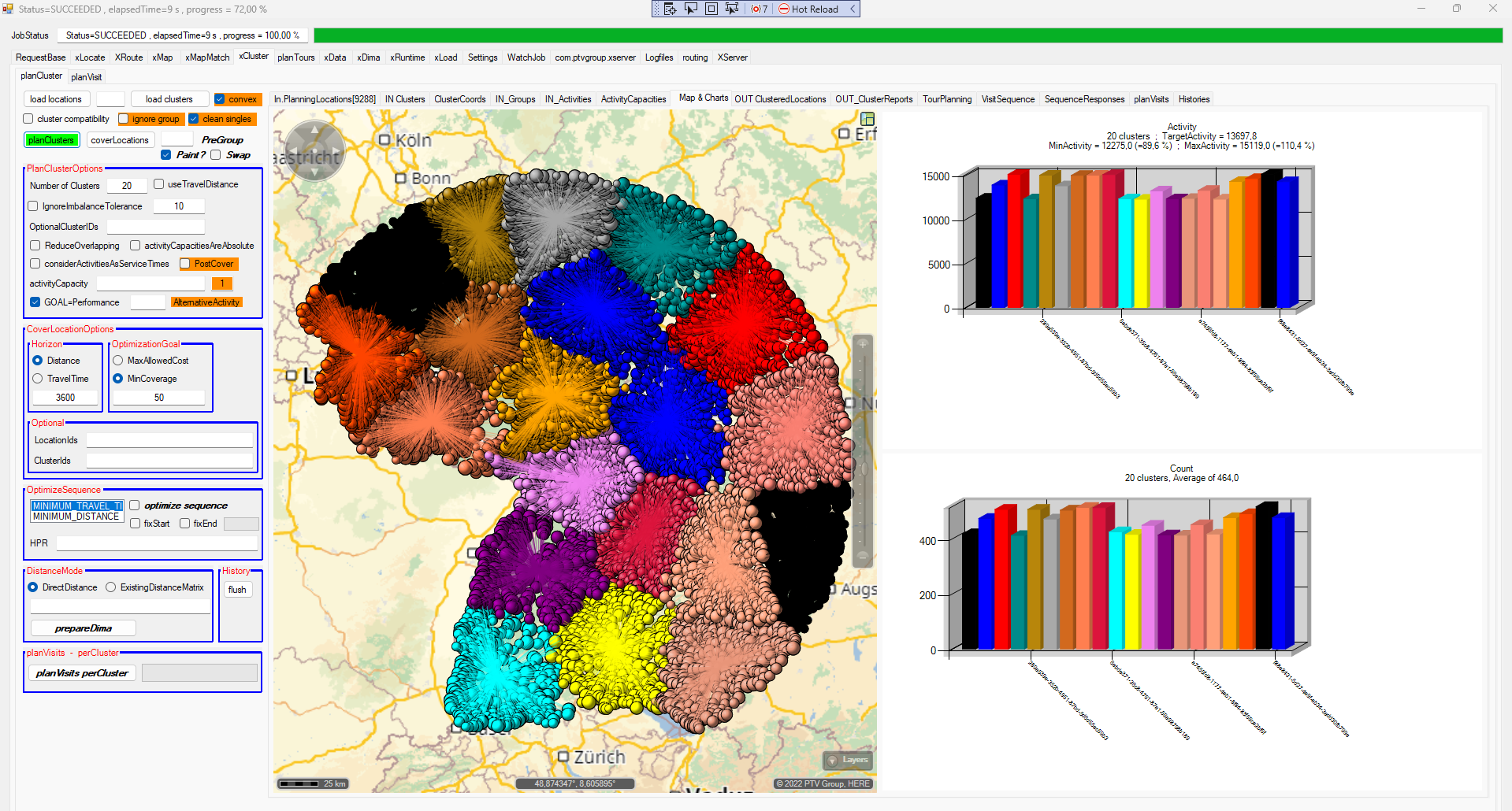

Just some fancy experiment... I took almost 10'000 locations with zipcodes and activities.
  • the native 9288 individual locations
  • preaggregated into 2779 representing "zips" with accumulated activities
From my perspective you wouldn't loose quality if you aggregate...
But you need less resources.
