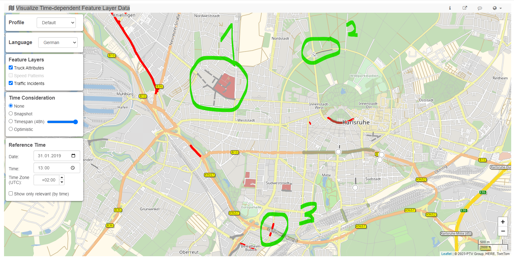

I recommend that you evaluate the following showcase Visualize Time-dependent Feature Layer Data which perfectly shows the behaviour of attributes through the TimeConsideration modes NONE / Snapshot / Timespan.
1. PTV_TruckAttributes: time dependent restriction  (forbidden during the night, area of the hospital)<br />2. PTV_TrafficIncidents: a time dependent impact (construction site)<br />3. PTV_TruckAttributes: a time INDEPENDENT height restriction due to a tunnel
So if you transfer this to routing we can conclude:
  • if you do not specify a TimeConsiderationMode only those attributes are considered which are "time independent" (no matter whether we talk about truck attributes, traffic incidents or any other category with time dependent contribution)
  • For speed patterns the visualization with TimeConsideration=NONE doesn't make sense: speed patterns are time dependent by design ;-)
And as Max mentioned: please check the Technical Concept: Time Consideration.
