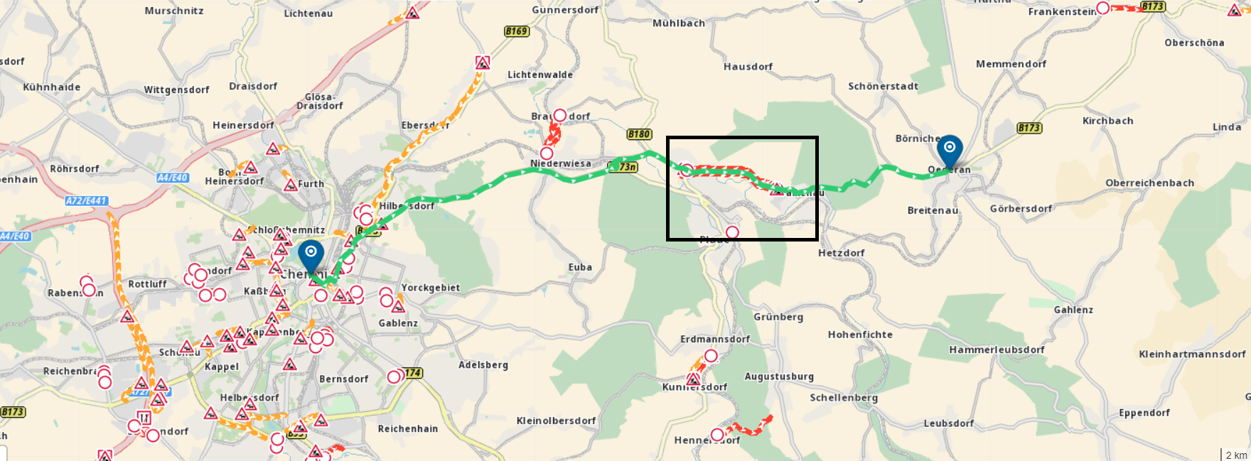

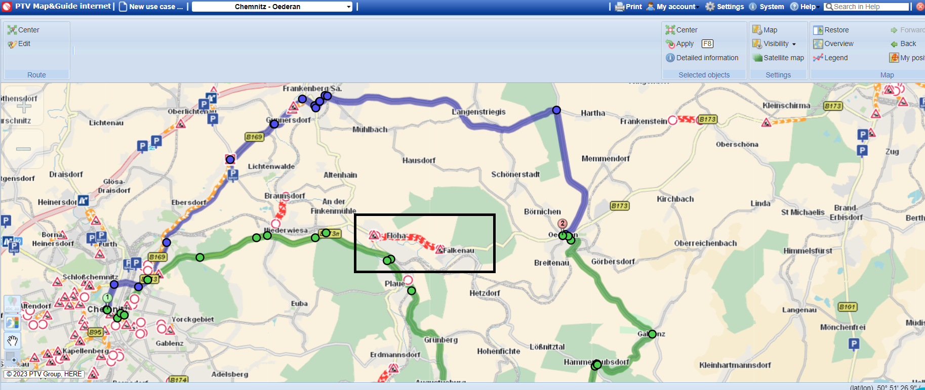

1. Map&Guide Internet:
As you can see, there is an ongoing road work, between Flöha and Falkenau.
MGI knows this one, so it skips that segment and gives a longer, but possible route. 2. xServer1:

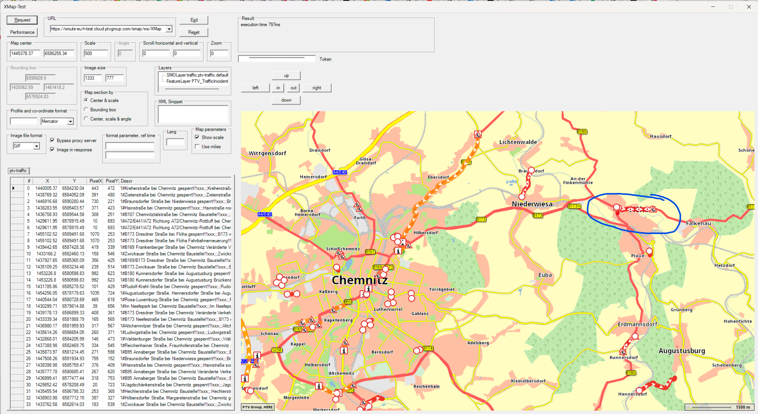

On the raffice map layer, we also visualize this roadblock, however in xServer1 this roadblock is bypassed. I also attached the xServer1 request.
Thank you,
Peter

here's some footage... processed through xroute-eu-h-test / Raw Request Runner:
Here's a routing request with the option set to consider that layer
Is this what you've been looking for?

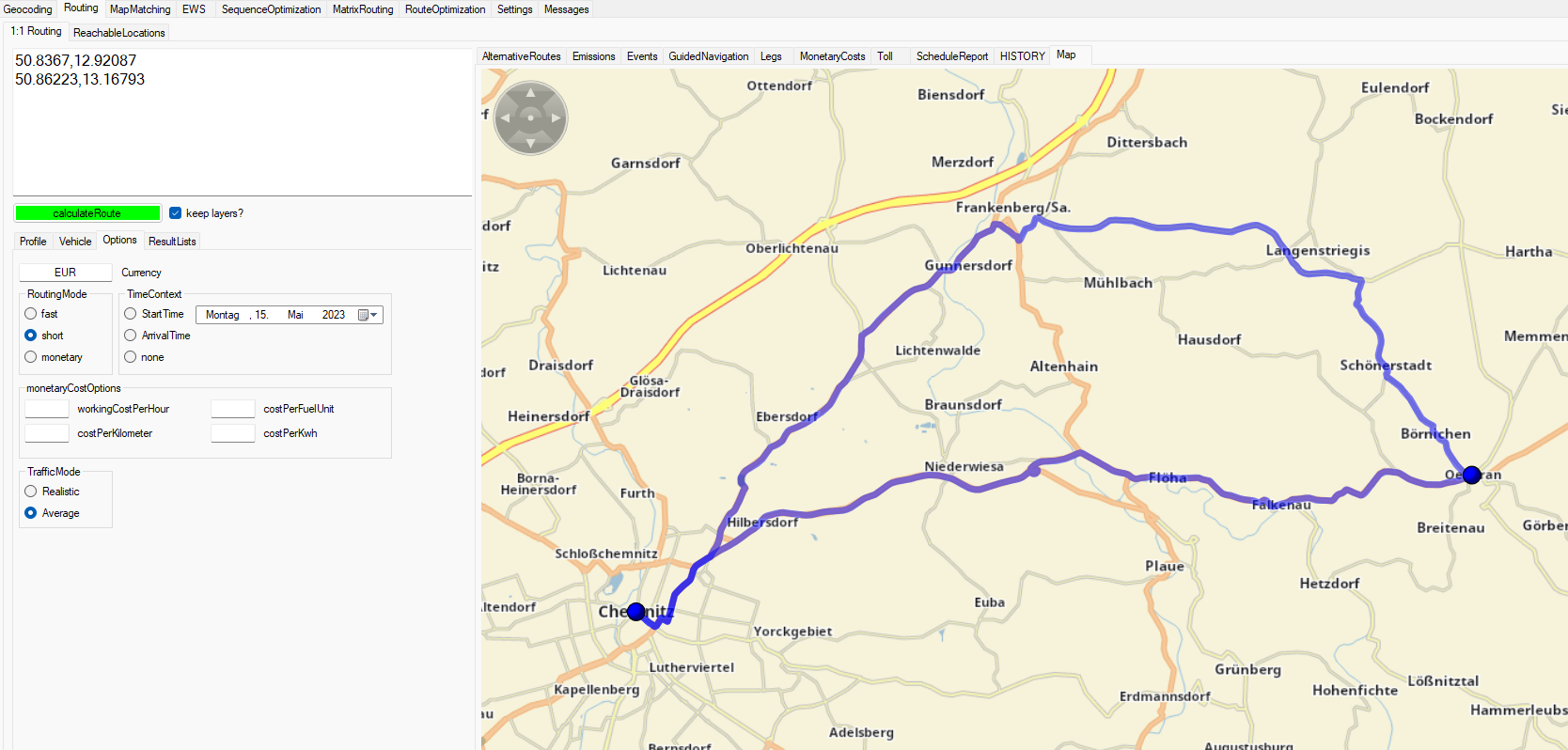

just some screenshots from DEVELOPER: Bernd
Re: Map&Guide Internet road blocks in xServer1
That looks great! It's the same problem, and so it also work in Developer.
https://developer.myptv.com/en/document ... ulateRoute
As I can see, It's much easier in Developer then, only need to switch the trafficMode option to Realistic from Average.
