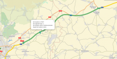

The missing distance is for the section "FONTAINE-LARIVIERE" and the opposite direction, right? The distance for this section by the provider (not in our data, but from https://voyage.aprr.fr/sites/default/fi ... r_2023.pdf) is 33.2 km.

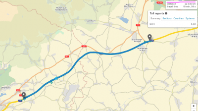

The workaround that you can do is to sum up the distances of all consecutive segments that have the flag toll=true before and after the PASS event which should be all segments that are rendered as toll road in the following screenshot. If you do that you should get at least about 44 km more of toll distance as indicated by the second screenshot. That's the best you can do at the moment.
However, if you implement that you should also consider special cases like two consecutive PASS events where all segments in between have the toll flag (I found such situations for example in Florida).
