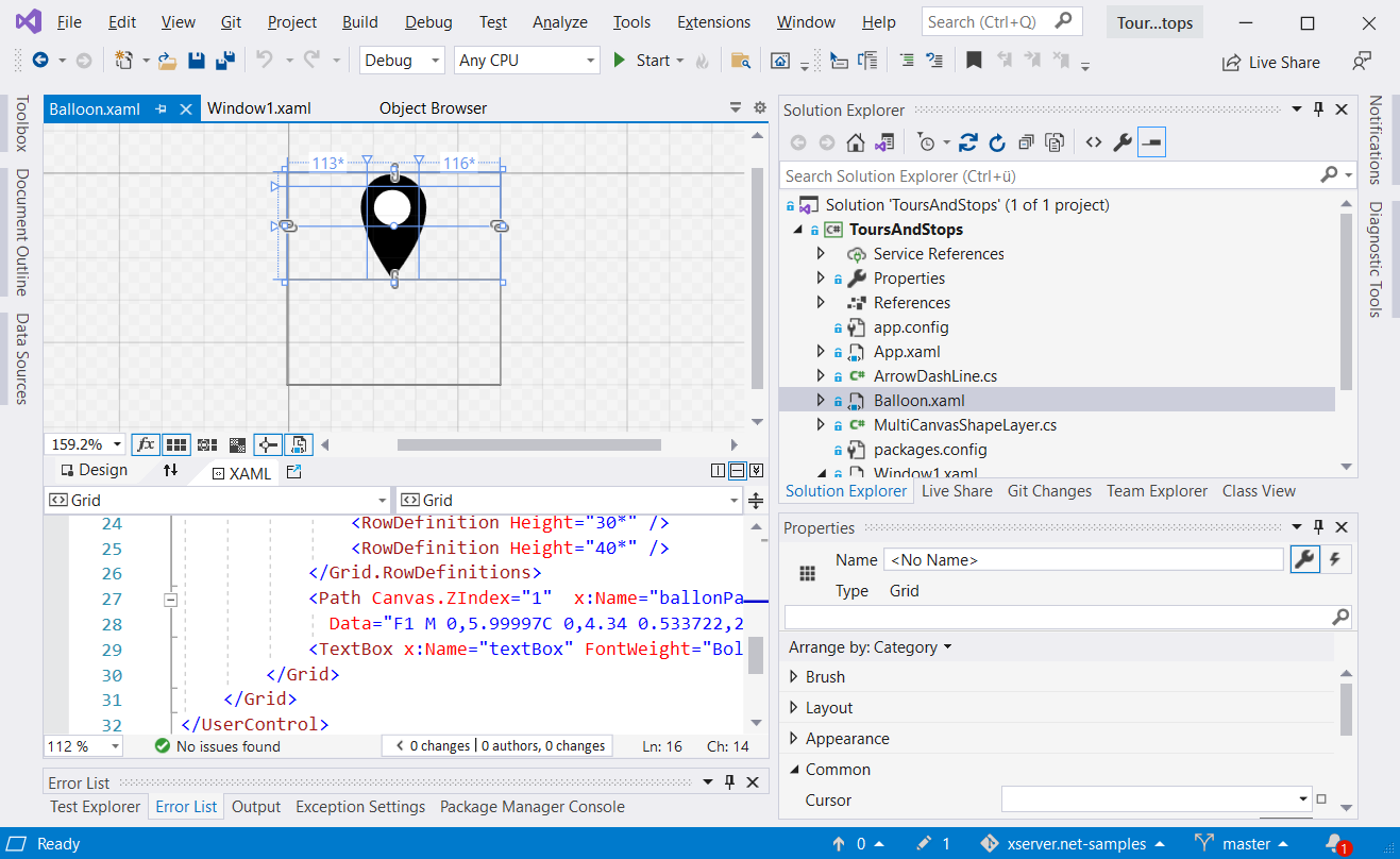

Just found further URLs in an old chat - maybe these documents could also help?
The following approach is base on "SVG icons that are converted to XAML": And it is also possible to display images instead (though this is less beautiful)
