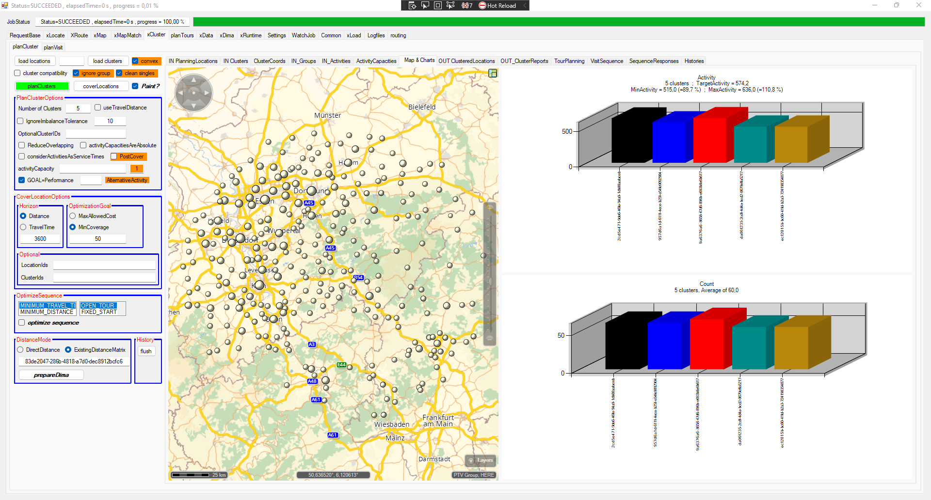

300 input locations
300 input locations

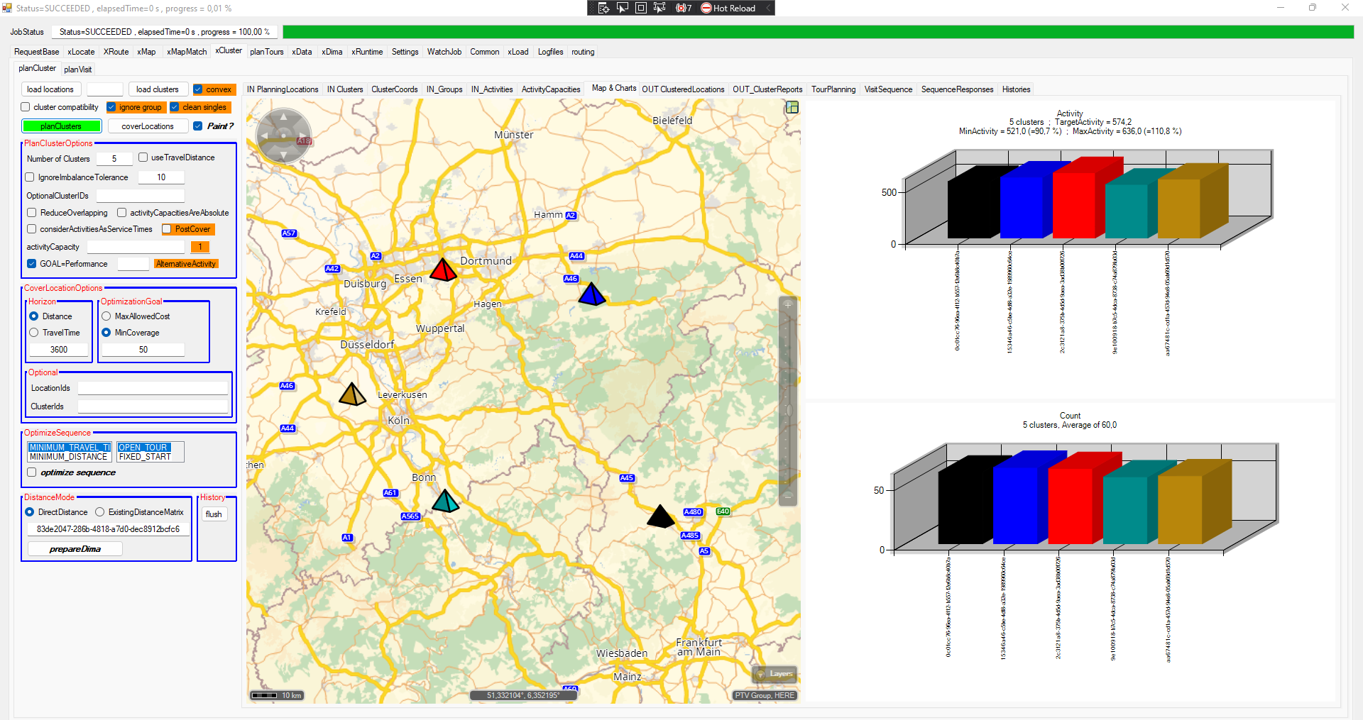

The centers determined via airline / directDistance

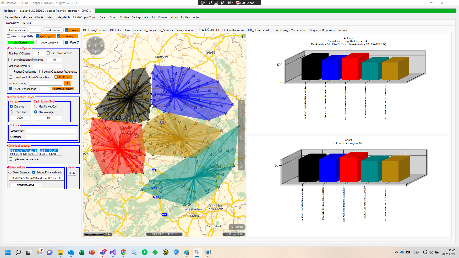

The assigned locations based on DirectDistance
The assigned locations based on ExistingDistanceMatrix

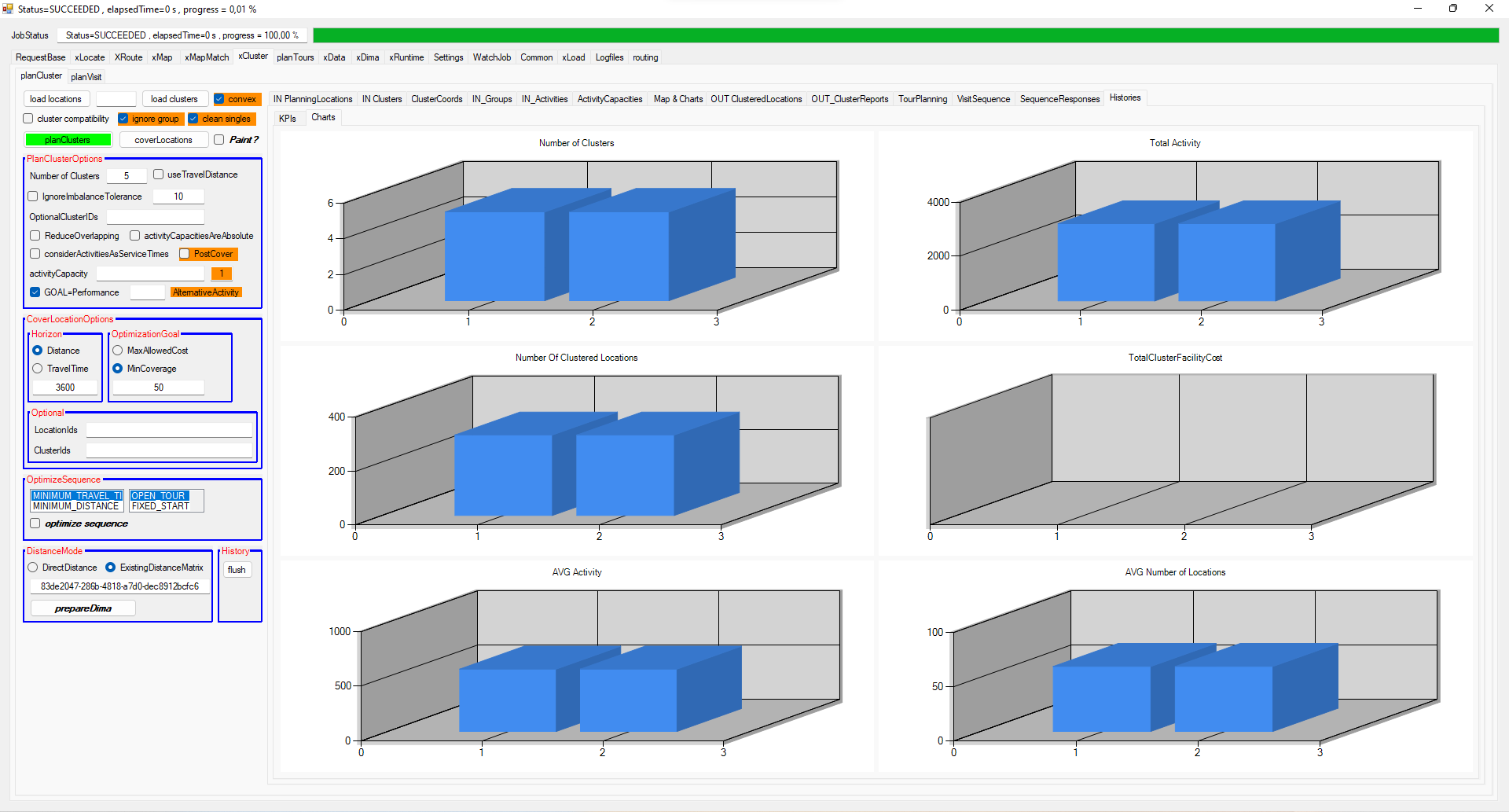

From a pure perspective of the KPIs returned by xCluster the results seem to be equal.

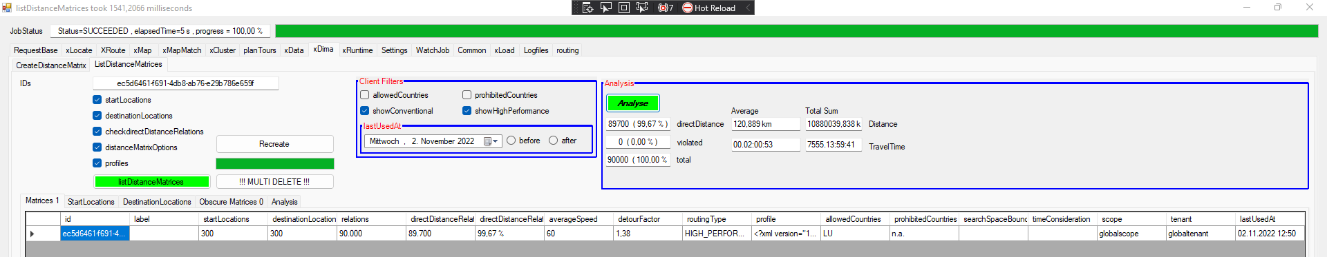

Comparison of the Distance metric KPIs (xDima2)
Here are the KPIs of the distance matrix itself (successful routing, average distance = 123.386km, average traveltime = 1:56:44)
Now the DIMA based on airline. Average distance = 120.889km with average traveltime = 2:00:53
