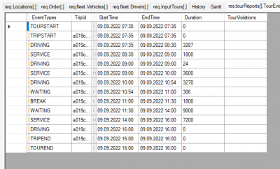

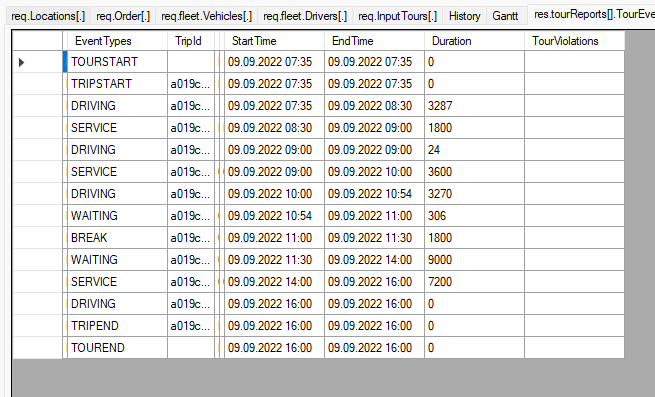

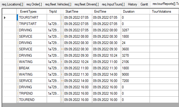

Here is just a comparison of two requests schedulung a 30min appointment.
One of them successfully schedules the appointment on the fixed time of 08:00 to 08:30. The other one shows a typical mistake: the length of the operating interval is set to the same value as the service period which allows the service to shift the appointment.
CORRECT - interval length is 0<br />&quot;openingIntervals&quot;:<br />   [<br />    {&quot;$type&quot;:&quot;GDFTimeDomain&quot;,&quot;timeDomain&quot;:&quot;[(y2022M09d09h08m00s00){s0}]&quot;}<br />   ],
"openingIntervals":
{"$type":"GDFTimeDomain","timeDomain":"[(y2022M09d09h08m00s00){s0}]"}
MISLEADING because of the interval length<br /><br />&quot;openingIntervals&quot;:<br />   [<br />    {<br />     &quot;$type&quot;:&quot;GDFTimeDomain&quot;,&quot;timeDomain&quot;:&quot;[(y2022M09d09h08m00s00){s1800}]&quot;}<br />   ],
"openingIntervals":
"$type":"GDFTimeDomain","timeDomain":"[(y2022M09d09h08m00s00){s1800}]"}
