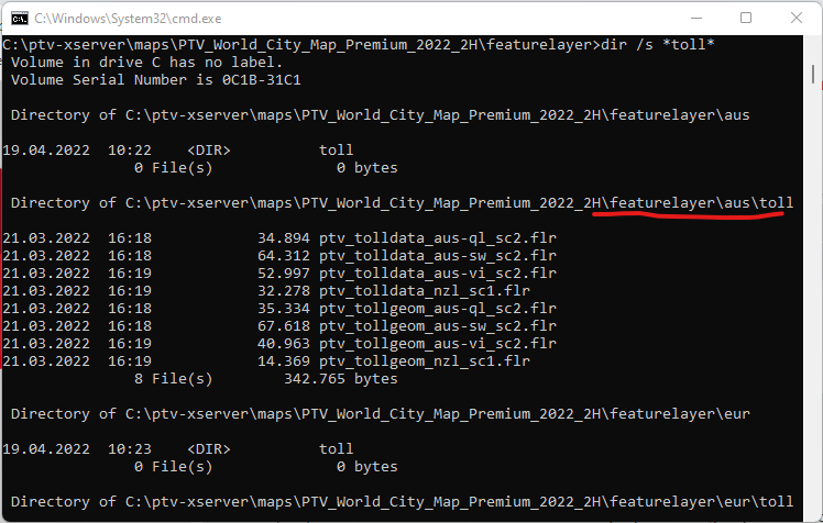

:idea: Solution To look for toll data within a map check the /featurelayer folder for /toll subfolders:
