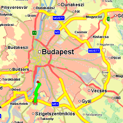

We plan between the following two points: [47.374779, 19.048795 - HU] & [47.425411, 19.064196 - HU]

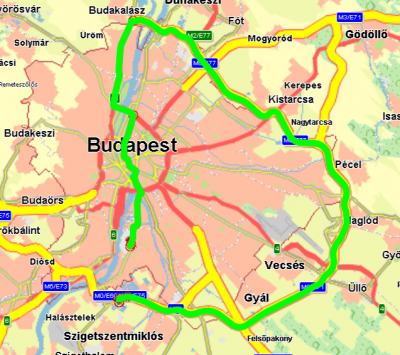

As a result we receive a route which has a huge detour around the centrum of the city.

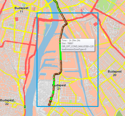

I've checked the segment attributes and I noticed on the last section theres are some DIR_OPT_COND_MALUS5|0=120 restrictions, which means the road is closed for vehicles heavier than the given weight except for residential vehicles.
In our case the vehicle is residental (as we transport goods there), so we can use these segments.
BUT if that is the case, why dont we use the following road which is much shorter and doesn't take the detour?
I've received that alternative route with RoadEditor layer turned off, but I don't see any other limitation other than that DIR_OPT_COND_MALUS5|0=120 limit.
The question is: If there are the same kind of restrictions on both routes, why can't we use the shorter one with RoadEditor options?
Is there a calculation on how much distance we have to drive on these restricted segments? And in the first case this distance is shorter from the north side?

I think there is a misunderstanding of the DIR_OPT_COND_MALUS5|0=120 :
The effect of this segment attribute depends on the vehicles conditions!
Your profile contains the following
<KeyValue key="DirOptCondMalus5" enabled="true" malus="2500" threshold="40000"/>
What we do is we compare the segments value (in this case 120) with the value of the vehicle (in this case 40000). If the vehicles value exceeds the segments value (this is the case in the current lot) we apply the given malus (in this case 2500).
(PS: the value'S meaning is weight and is based on 100kg, so 120 means 12000kg, 40000 means 4000000kg... probably not meaningful range)
In the end this means that we accept a detour up to factor 2500% (25 times original costs). And this is why we may return a 80km track instead of 6-8km (more or less direct connection).

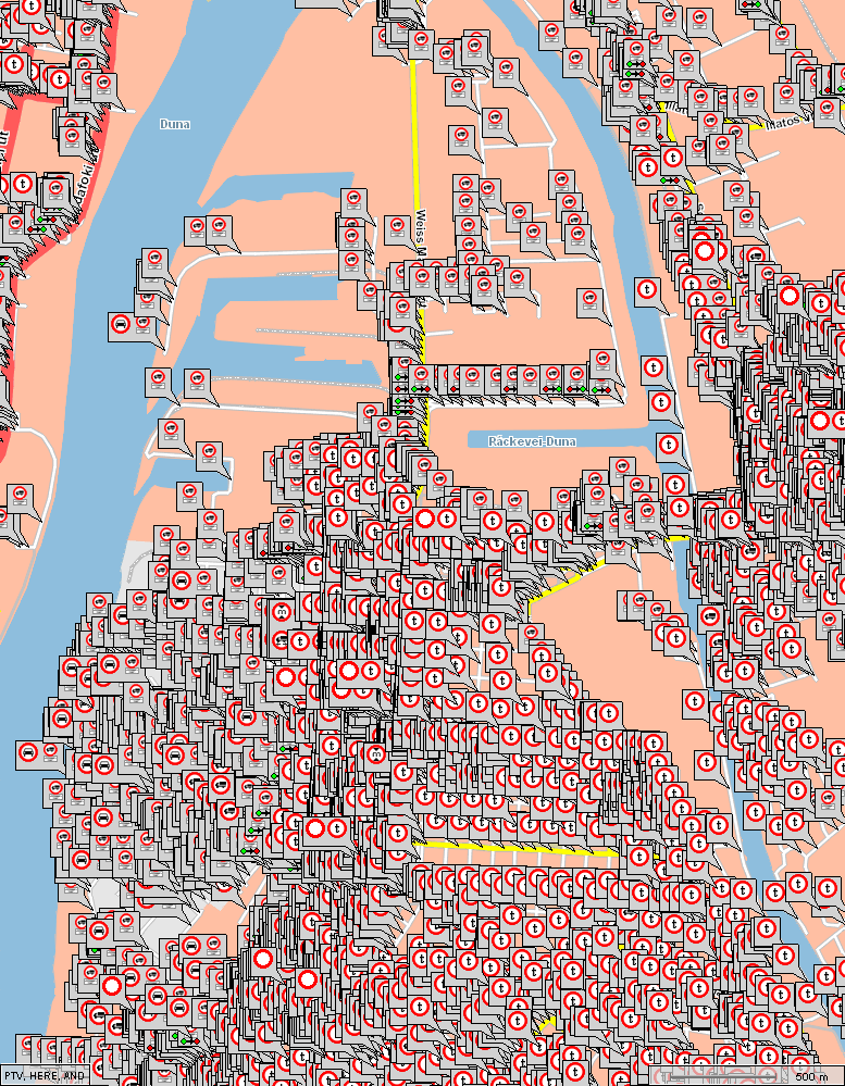

Looks like almost every segment near the industrial area is a reason to perform a detour (see screenshot)
area near the industrial zone
If you want to allow the vehicle to drive through that area you may have to
  • disable the malus
  • set it to a more tolerant malus value (0=I don't care <=> 2500 accept long detour)
  • reduce the vehicles value (weight, e.g. 119)

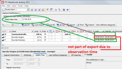

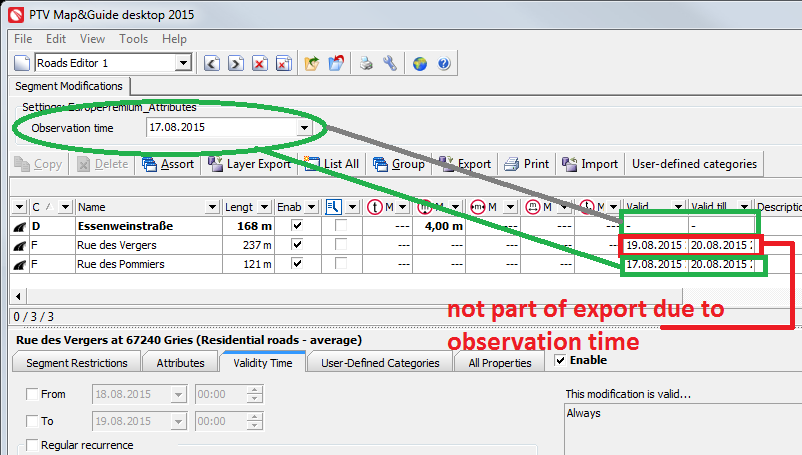

If you use MAP&GUIDE RoadEditor database layer you may specify the time context of a route:
The xRoute will then call an internal method which creates a BIN file on the fly. This BIN file is something like an export from the MAP&GUDIE database that filters only such blockings that are available at the given routing time.
Compare it with MAP&GDUIDE RoadEditor layer export
The time dependant  blocking from 19.-20.08.2015 is not part of the export into the BIN file because this interval doesn't match the export timestamp. The othe two blockings appear in the BIN file because they are<br />- not time dependent<br />- matching the interval
