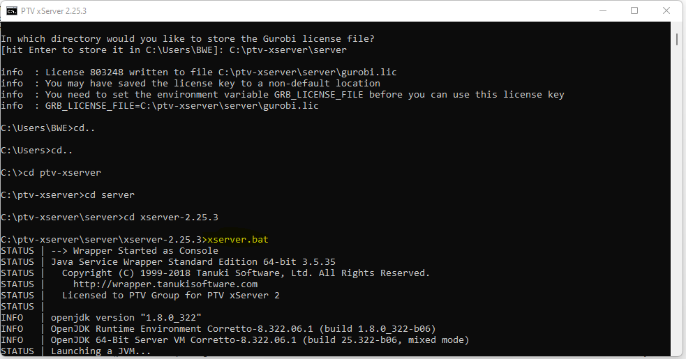

As a temporary solution I decided to run my xServer from the command prompt:
solution: I started the server from the command prompt
