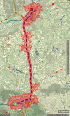

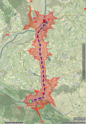

What is possible with the xServer2: computation of the corridor aka fence!
2.5km  /  5.0 km fence (default profile)
If you are able to gather a drivers current position while he is supposed to follow a specific track you could create an alert once the GPS position is no longer inside the computed geometry.
I took com.ptvgroup.xserver.xroute.ReachableAreasRequest.

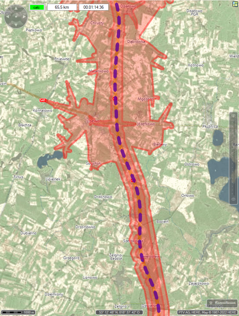

And here comes the 15min corridor...
Complete route: in urban areas with a detailed road network the areas are covering much more space.
