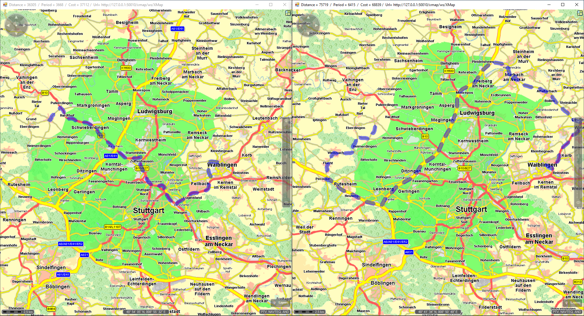

Here's a quick sample about how to consider the greenzones during a routing with xRoute1.
For both routings the GREENZONES apply a malus of 2501 (strictly forbidden). <br />Waypoints: &quot;71735 Hochdorf an der Enz&quot;  --&gt;  &quot;7133* Waiblingen&quot;<br />Left: Vehicle has a green vignette - passage is allowed<br />Right: vehicle has a RED vignette, therefore it must perform a detour
Waypoints: "71735 Hochdorf an der Enz" --> "7133* Waiblingen"
