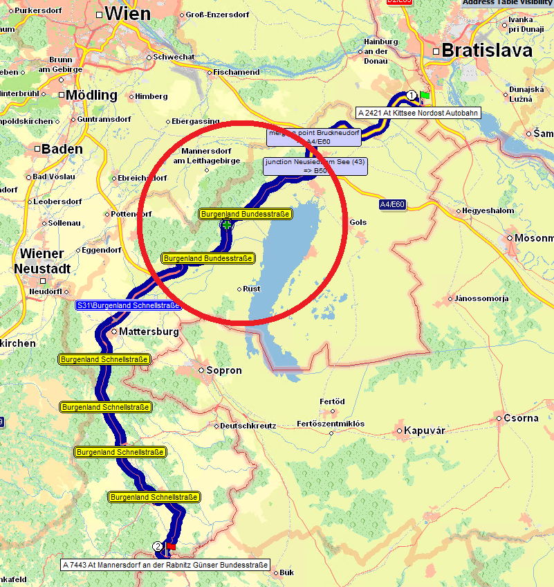

When I plan between these 2 points
48.071484, 17.070274 - AT
47.407423, 16.51414 - AT
Map&Guide provide the following route when using the default 40t truck profile:

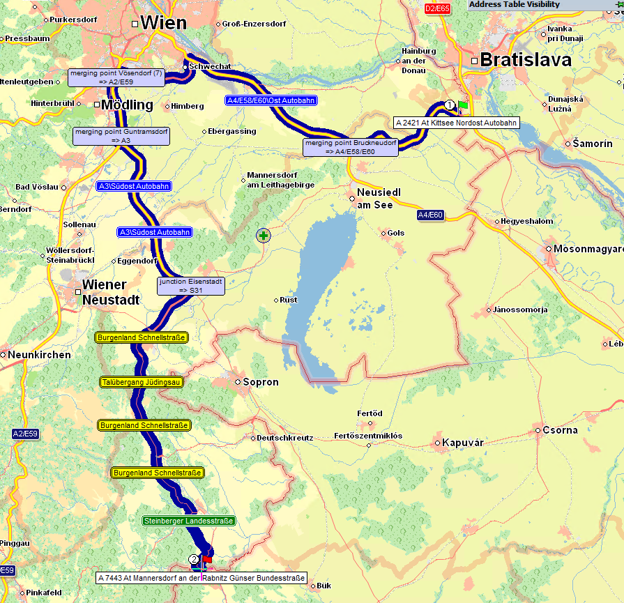

When I plan again between the mentioned 2 points, but this time with xRoute and the default 40t truck profile, I get a different route:
I've checked the problematic part of the route and according to the segment restrictions, there are some 3.5t limitation on it (red circle). I guess that's the reason why we try to avoid it in Map&Guide.

M&G vs xRoute route

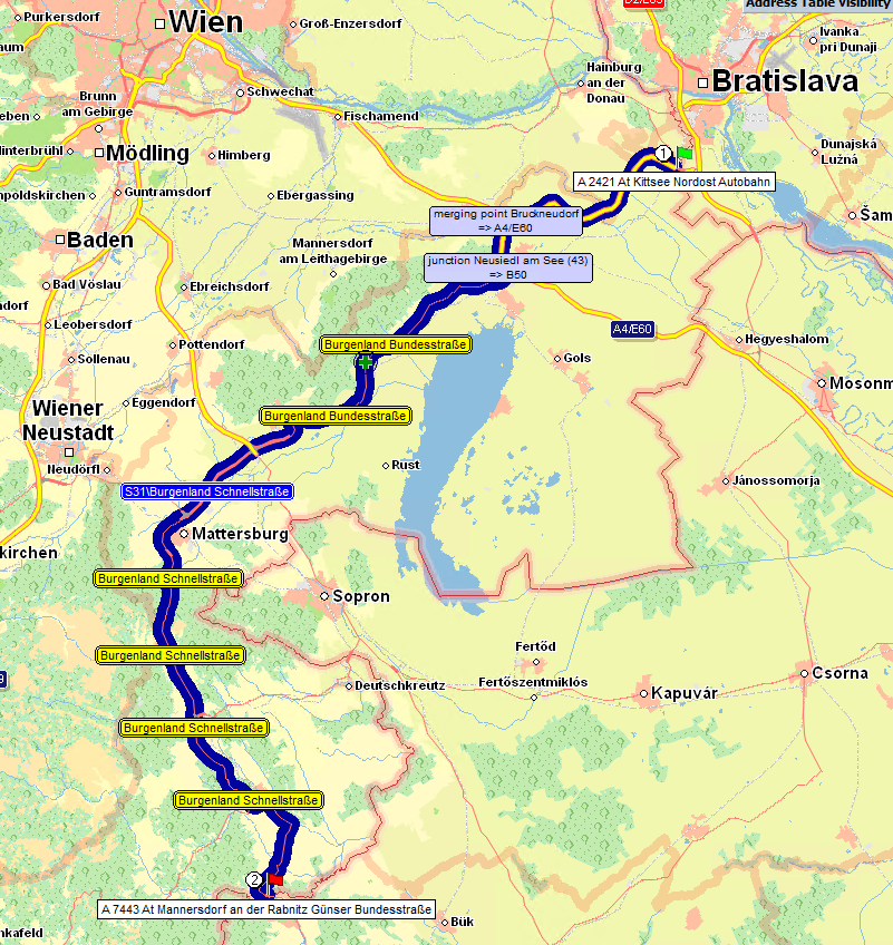

Hello Zsolt,
I used the XRouteToll testclient to make some analysis with your data in combination with xRoute 1.20.0.0 and PTV_Europe_City_Map_Premium_2015_1H.
Probably a question of the RoadEditor=true versus RoadEditor=false...
I copied the whole XML profile in the test clients ProfileSnippet section and enabled/disabled the @additionalDataRules / @VehicleSpecifc.
If the RoadEditor is enabled the route performs the same detour as with map&guide.
If the RoadEditor is disabled it takes the direct connection.

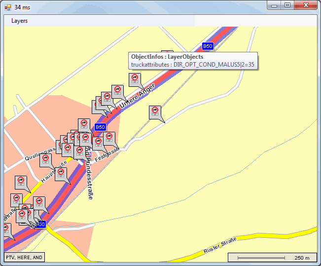

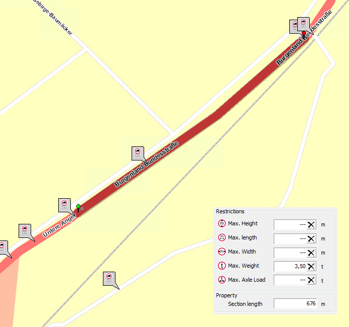

Re: M&G vs xRoute route
Hey guys!
Sorry but I still have a question in connection to that issue.
I've checked the profile modification that you've sent Bernd, but:
In Map&Guide when checking with Road Editor I see a 3.5t weight limitation on the road north east of Einsenstadt (47.856380 16.634197 - 47.864280 16.645763).
But when planning with xRoute that limitation doesn't appear on the segment restrictions.
I've attached 2 pictures: A Map&Guide pic of a problematic segment with the restrictions, and the planed xRoute track which doesn't have the limitation.
Any idea why can't we see the restriction in the xRoute results?
these segment attributes are a bit special. They have conditional restrictions, which are included in the truck attributes but not represented in the profile.

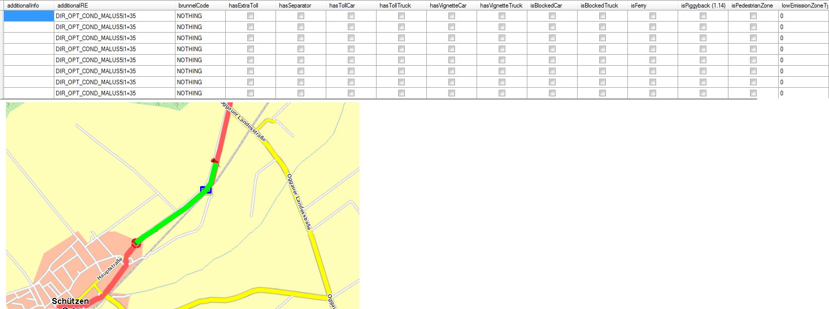

- Posts: 3100
Hello guys,
the testclient XRouteToll used for the xRoute access supports both
Not an engine error but a lack of the test client... but: works fine with the approach 1 (traditional mapping)
I found an old piece of documentation that describes that this malus value is interpreted as follows:
PS:
Some text from the ancient doc...
- traditional mapping
- xServer.NET based mapping
- The segment has a condition: 35.
The vehicle has a corresponding value.
If the value of the vehicle exceeds the segments value, the malus is applied on the segment. - But: neither the profile nor the request does not mention the vehicles explicit value. I assume the default vehicle value is 0. Which means: no need to apply the malus: use the segment.
- By parametrizing the vehicles value with DIR_OPT_COND_MALUS5=2500;666 we exceed the segments value, the malus is applied and we take the detour. That's it...
