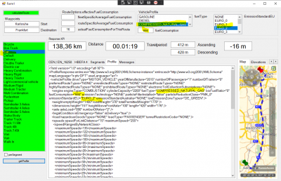

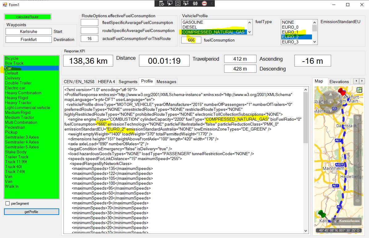

Example: A screenshot from my latest version of the Emission2 calculator (HBEFA4 / CEN=EU_16258):<br />While most of the routing attributes are taken from the stored profile &quot;Car&quot; I am overriding some parameters through the request profile. The &quot;profile&quot; in the textbox shows the effective profile.
While most of the routing attributes are taken from the stored profile "Car" I am overriding some parameters through the request profile. The "profile" in the textbox shows the effective profile.
