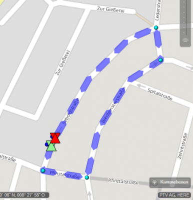

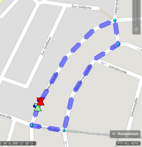

  • Dummy routing 1 : (x,y) to (x+delta,y+delta), kind of faking a minimal route y shifting the (x,y) by delta: Attention - For segments with a restricted driving direction this could lead to circle routing which will then be based on various segments and not just the desired one. Further more the delta would depend on the coordinate format. Otherwise you get an empty route.
    route via <br />8.4676704364,48.999748192<br />8.4677704364,48.999848192
    route via
