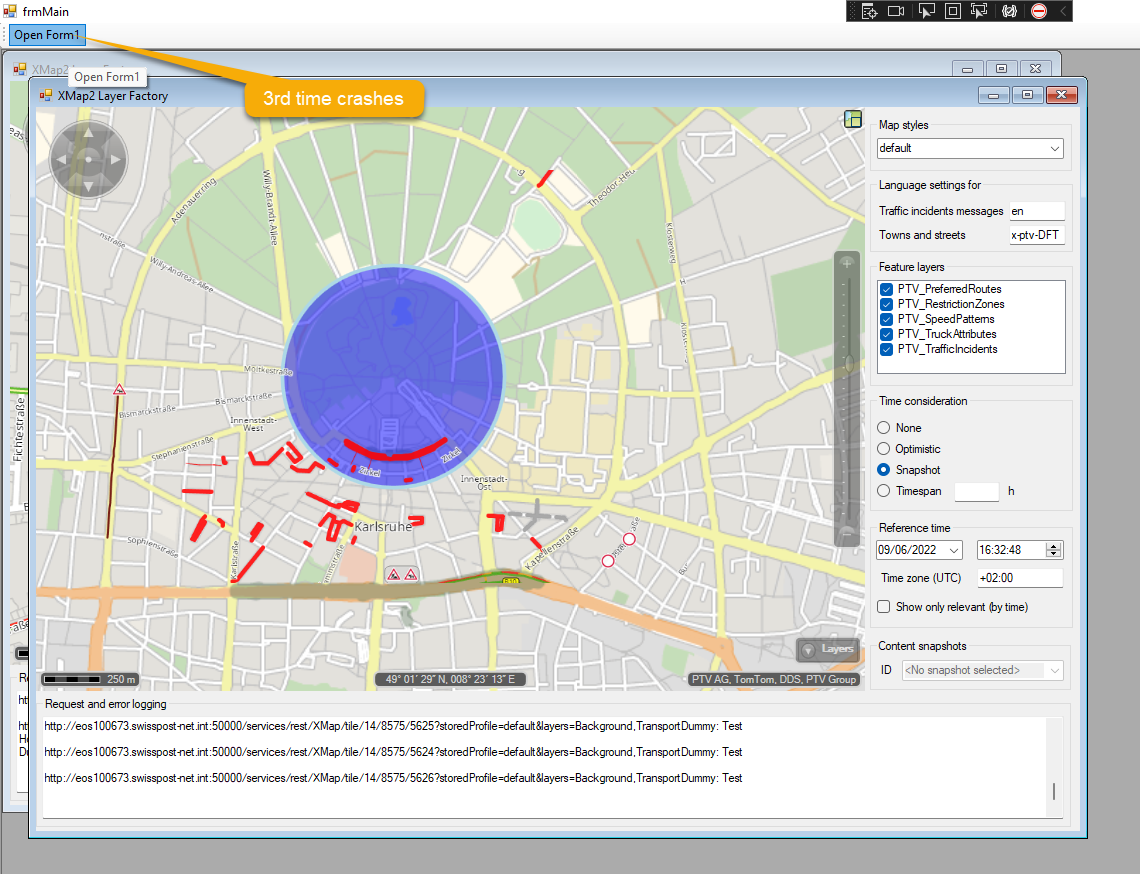

Re: FormsMap.XMapUrl exceptions assigning the xMapServer URL
Hello Oliver
Can you please help me with the initialization of the XMap2 using Feature Layers?
As explained below, I have followed two projects, the first focusing on feature layers and the second avoiding "smart" Uri detection in the FormsMap.XMapUrl property. But in both approaches, the initialization of the map Uri causes me problems.
1) I followed the FeatureLayer code-sample:
Xmap2LayerFactoryTest #xserver-2
Issue:
It works very well, but it crashes if the FormsMap control is initialized more than 3 times during the same application execution. It crashes when the URL is assigned in the FormsMap.XMapUrl property.
I have created a sample project to illustrate the problem.
2) To avoid FormsMaps "intelligent" Uri-detection, I then explicitly initialized the control following the "XSTwo" code-sample as described in the topic: https://xserver.ptvgroup.com/forum/view ... map2#p1350
Issue:
It works well and I can then open the map several times, but the problem is that then the FormsMap.Xmap2LayerFactory is not initialized.
Thank you in advance for your support.
Kind regards
Pedro Diogo
Issue:
Issue:
Kind regards
Pedro Diogo
Hello Pedro,
this looks like the number of (ephermal) connections isn't enough. Adding a
ServicePointManager.DefaultConnectionLimit = 64;
at your application startup for example increases the default limit and fixes the timeout. I would generally recommend to specify the limit, the control itself doesn't make any changes there.
Oli
Oli
Hello Oliver
Oh yes, you are absolutely right. It works perfectly now.
Thank you for your quick response.
Pedro Diogo
Pedro Diogo
