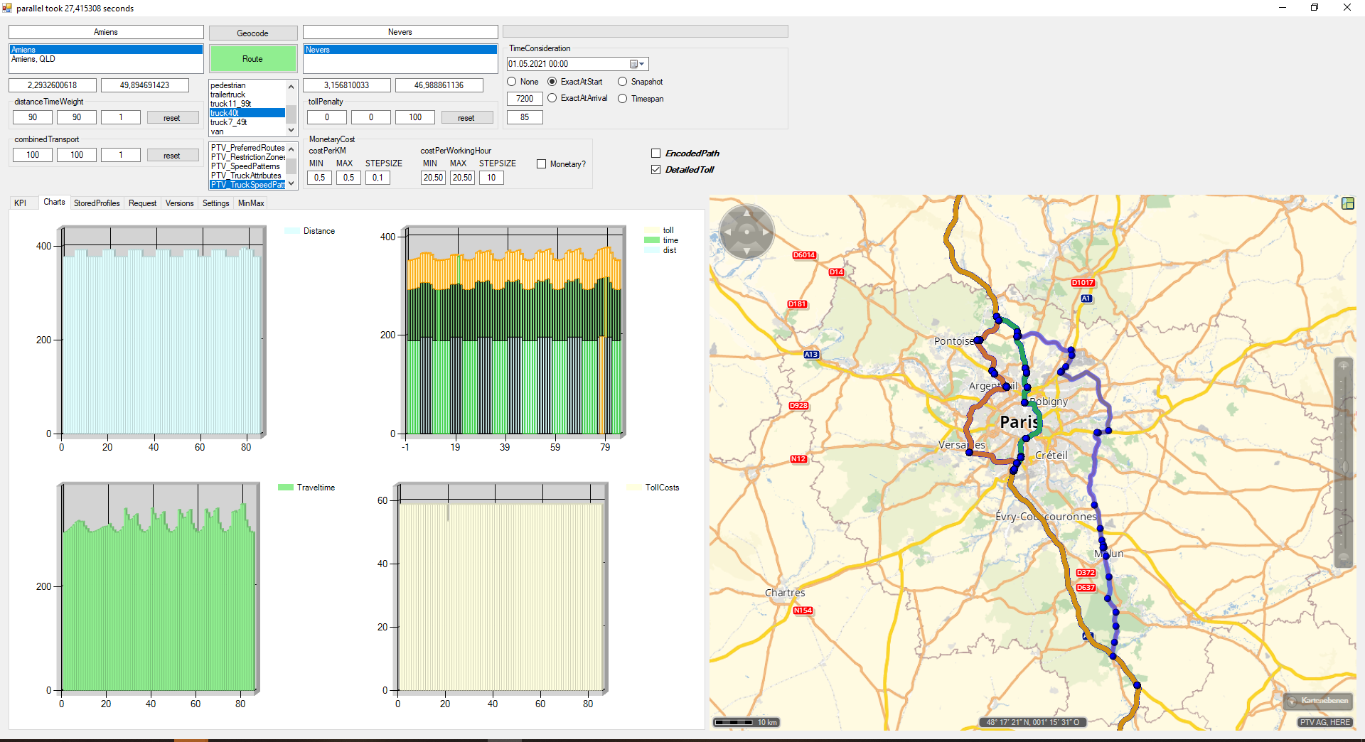

Here is a sample of 85 routings starting at <br />SAT 00:00, SAT 02:00, SAT ... FRI 20:00, FRI 22:00<br />You can see the different geometries depending on the time of the day (check the charts)...<br />(From F-Amiens to F-Nevers)
