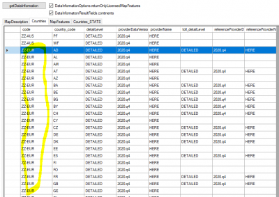

- Posts: 2936
Re: Search location param for region Europe
You could also use the following xRuntime request to gather the ISO 2 country codes of the countries in the map
"dataInformationOptions": {
"returnOnlyLicensedMapFeatures": true
"resultFields": {
"continents": true
- Attachments
