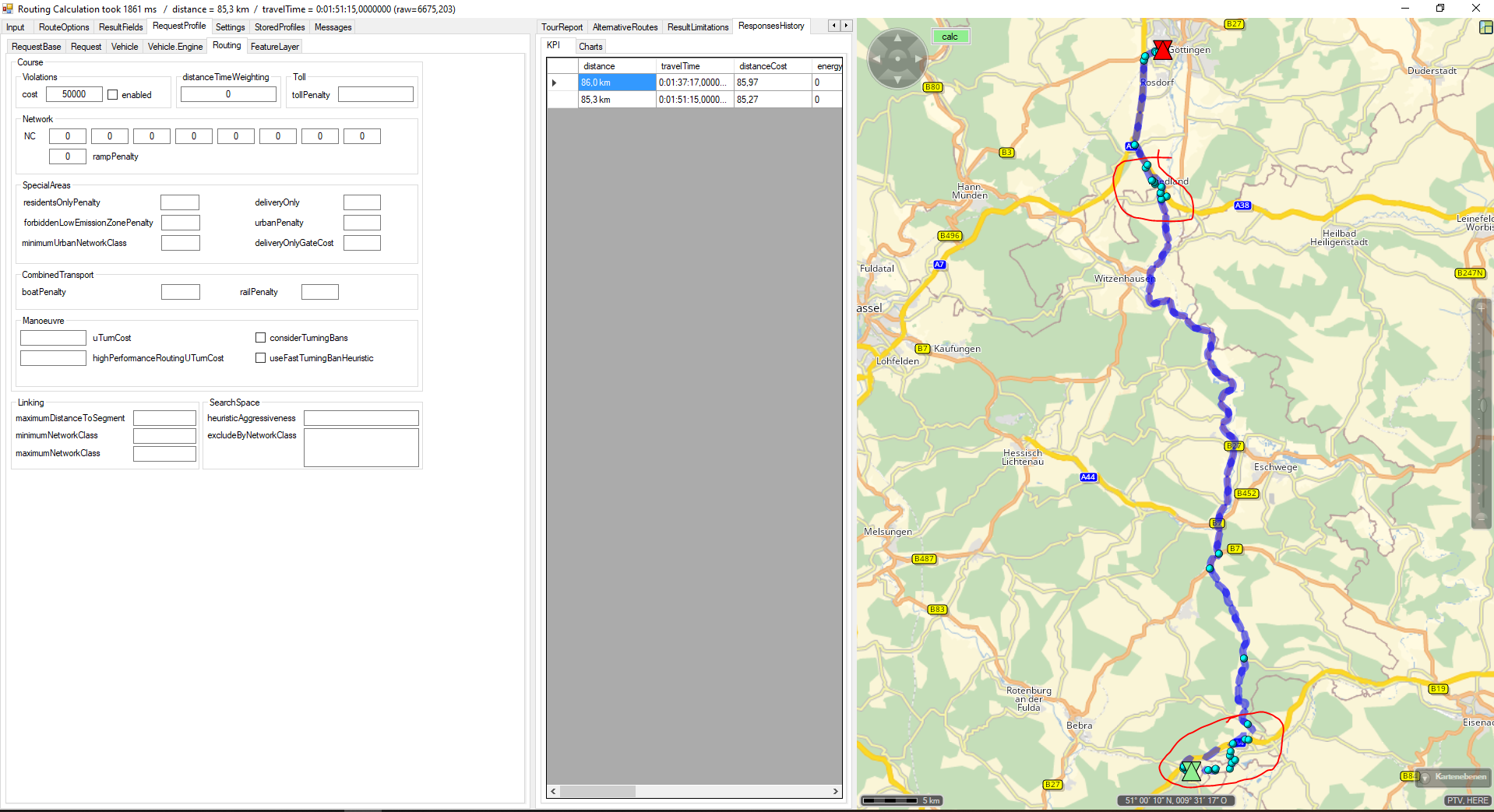

86km  /  1:37<br />This alternative applies a 0 malus on the higher network classes.With this setting I even managed to get a faster route...
86km / 1:37
132,4km  /  1:47
132,4km / 1:47
85,6km  /  1:39
85,6km / 1:39

Hi Mobi, Joost,
I am already in touch with the tech team in the headquarter. We will check who will return to you 1:1.
From my perspective it is just the superpositioning of many, many factors at the same time which makes it hard to understand that there's no bug.
And by the way:
the attached screenshot displays the two routes with
- TruckAttributes being considered (violations disabled)
- Stored Profile = 11.99t truck
- penalties disabled through the request
shortest track is shortest, fastest ist fastest,<br />no conflict<br />Just two local detours (red lines)
no conflict
Looks good, doesn't it? I saw the strange conflict while the penalties have been enabled.
But if I remove their effect by setting them all to 0 the result is as you'd expect it.

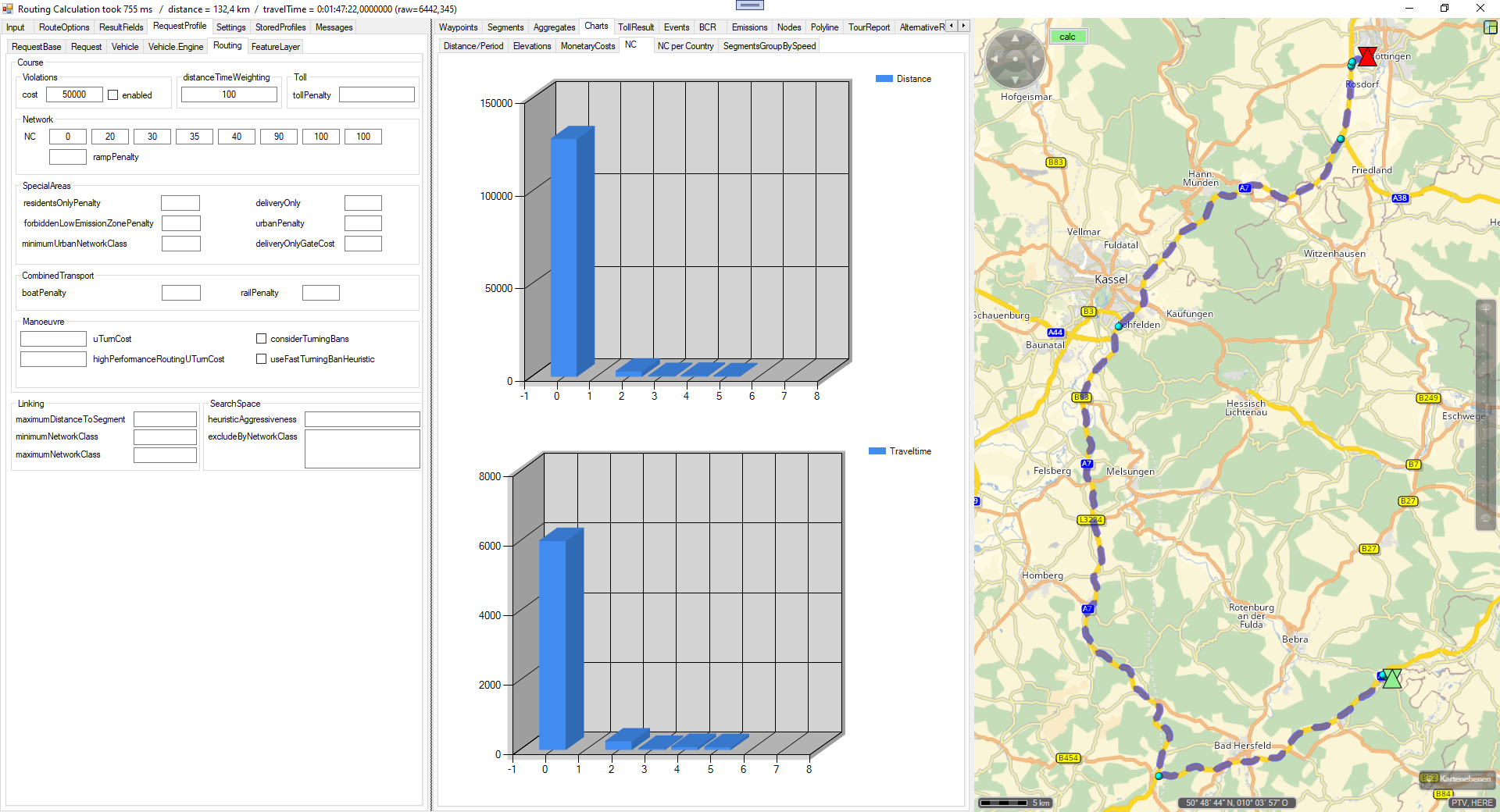

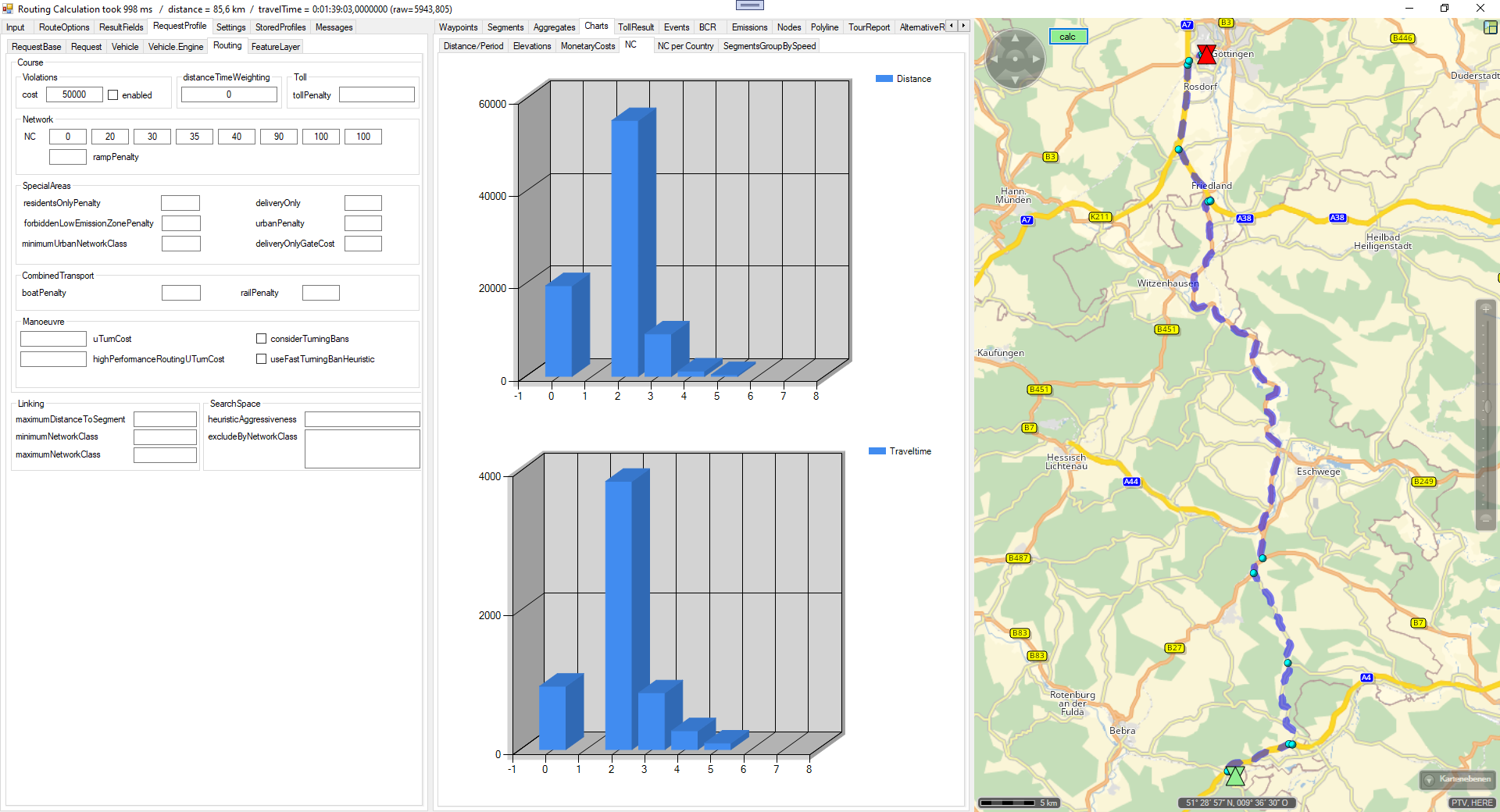

Looking properly at it I can explain the effect.
So we have the route that take the highway around which is 132450 m in 6446.185 s driving time. Let's call this one the outer route. And we have the direct route on trunk roads which is 85750 m in 5858.583 s. Let's call this one the inner route. The inner route is not strictly on trunk roads only (for example take a bit of highway at the end) but for simplicity let's pretend that it is only taking trunk roads. Also let's pretend the outer route only takes highway. The avoidance on trunk roads is 30 with the default values. So let's do the math on how our engine will evaluate both options under different value of distanceTimeWeigthing.
  • So for 0 (pure distance) our engine will compare 132450 again 85750 * 1.3 = 111475. 111475 is the lowest so the inner route wins and is being returned.
  • For 100 (pure time) our engine will compare 6446.185 s against 5858.583 * 1.3 = 7616.1579. 6446.185 is lower so the outer router wins and is being returned.
So i would explain your problem as:
The distanceTimeWeigthing is a weighting in the algorithm, it is not the goal of the algorithm. It is not there to force the shortest or fastest route, it is there to tell the engine when looking for the best route how much value it should actually attach to both the properties when evaluating route. Most of the time change in the distanceTimeWeigthing will line up if it was threated as the "distanceTimeGoal", but not always.
As for the avoidance:
We put avoidance on certain road types for our profile since we know that driving a route isn't always accelerate at the start, activate cruise control , and break at the end of the route. If there are for example traffic lights it means an extra stop and start witch costs fuel and wear and tear on the engine in compared to driving on cruis control. Als smaller roads are more likely to have inclines and sharp turns which again cost more energy and engine wear and tear to take.
So when comparing the outer route to the inner route it is not as simple as saying 132450 m in 6446.185 s vs 85750 m in 5858.583 s. In reality it is comparing 132450 m in 6446.185 s vs 85750 m in 5858.583 s with (for example) 5 traffic lights, 12 sharp turns and 7 steep inclines. To prevent the algorithm from being to overly complicated with simplify this to 132450 m in 6446.185 s vs 85750 m in 5858.583 s with "30% extra penalty to take into account all the situation that cause extra energy use and extra wear and tear"
I hope this clarifies it a bit for you.
