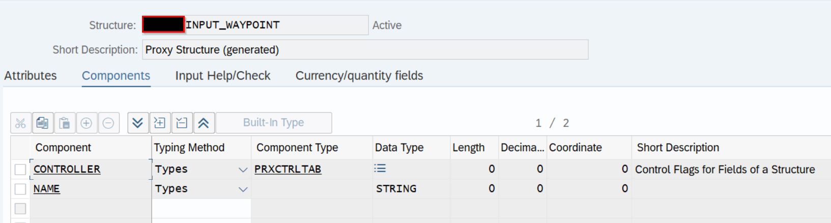

The waypoints table was generated based on the structure with "Controller" and "Name" fields.
Like it was read by SAP Logic in WSDL File.

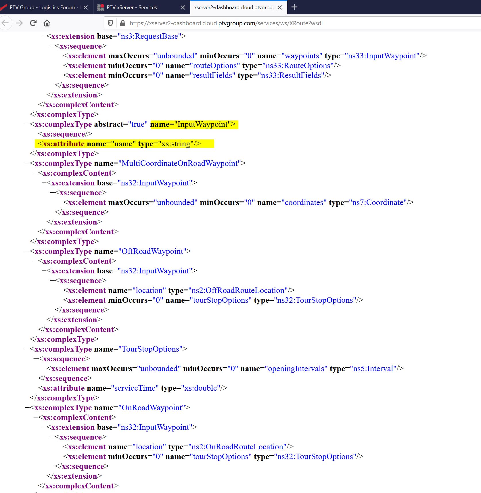

SAP Generated dictionary structure:
WSDL FIle:
Would it not more convenient to have in INPUT_WAYPOINT table a structure just with X, Y fields to have a possibility for direct initialization ? Are there any Ideas how to fill INPUT_WAYPOINT table with current apporoach ?

Hello YNik,
my own contribution isn't SAP based but could help anyway:
The class com.ptvgroup.xserver.xroute.InputWaypointitself is an abstract base class class and not used in the source code itself. Instead you would need to instanciate one of the following classes:
- com.ptvgroup.xserver.xroute.PathWaypoint
- com.ptvgroup.xserver.xroute.OnRoadWaypoint
- com.ptvgroup.xserver.xroute.OffRoadWaypoint
- com.ptvgroup.xserver.xroute.MultiCoordinateOnRoadWaypoint
- com.ptvgroup.xserver.xroute.ManipulateRouteWaypoint
- com.ptvgroup.xserver.xroute.CombinedTransportViaWaypoint
