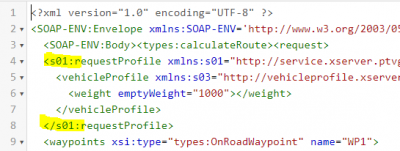

Hi!
I tried to read the directions in German from the directionDescriptionLanguage (ManeuverEvent).
According to the documentation, the userLanguage of the requestProfile must be set to "de". However, if I do that, I get an error:
Invalid content was found starting with element 's01:requestProfile'. One of '{requestProfile, geometryOptions, timeouts, userLogs, waypoints, routeOptions, resultFields}' is expected.
But the requestProfile form the RouteRequest is set as Type RequestProfile.
Look at the Documents:
soaplog_nok.txt -> the File with de requestProfile
soaplog_ok.txt -> the File without the requestProfile
Thnaks for help.
Martin.

Cheerio,
I checked your request. The problem is cause by the namespace reference:
malicious request...
How did you create it?
The following request works fine and by changing the "userLanguage" works like a charm...

Hi!
I spoke to our software manufacturer and I had to change the class structure a little and now the <s01: no longer comes. So everything works wonderfully.
