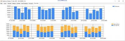

Sample result: 4 weeks cycle. Each day's aggregated service period is almost equal. Driving distances differ a bit.
