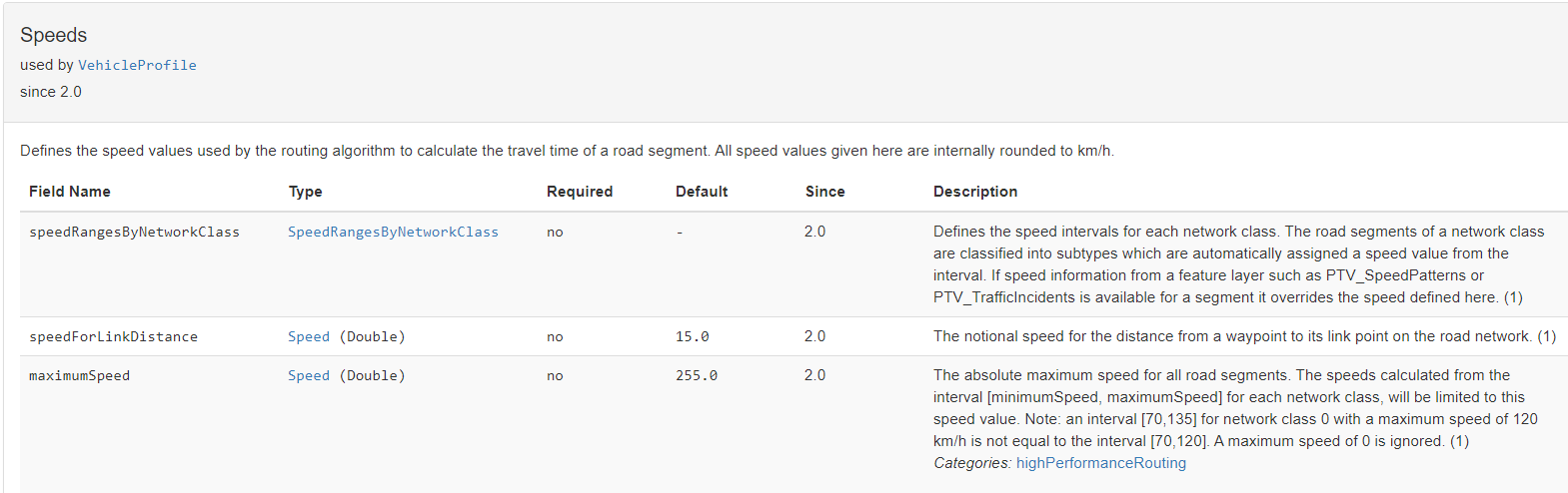

API doc says "default is 255"
We identified the maximumSpeed parameter as the cause for the gap:
https://xserver2-europe-eu-test.cloud.p ... ile.Speeds
Though the maximumSpeed is labeled optional with a default of 255 km/h the xServer2 result never drove faster than 80km/h. Now this is what you should be aware of:
- the xroute1 default profile does not contain a maxSpeed value, therefore the documented default value of 255 applies. As most routings deal with speed vectors below 255 we wouldn't have to cut speeds.
- the xRoute2 default profile explicitly mentions a maximumSpeed of 80km/h which means that the default value of the documentation is never reached. Instead of this the speed values will be cut to 80km/h if you do not explicitly override the maximumSpeed with the request.

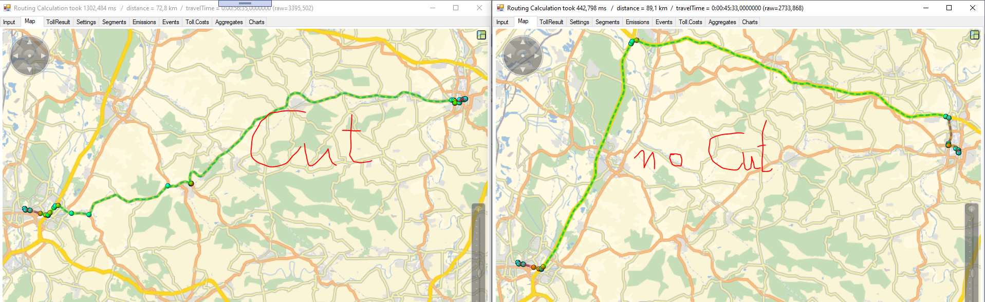

Both routings applied the same speed vector (130,90,80,50,50,40,40,40) and looked for the &quot;fastest&quot; route.<br />LEFT: no explicit maximumSpeed in the API call. Therefore an implicit &quot;cut over 80&quot; is applied due to the default profile. Therefore the detour as shown in the right image doesn't make sense.
Both routings applied the same speed vector (130,90,80,50,50,40,40,40) and looked for the "fastest" route.
LEFT: no explicit maximumSpeed in the API call. Therefore an implicit "cut over 80" is applied due to the default profile. Therefore the detour as shown in the right image doesn't make sense.
