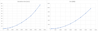

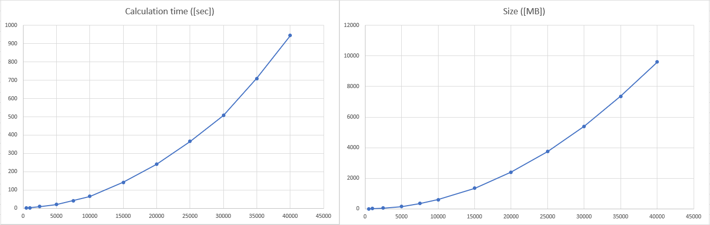

here is an overview of some sample computation based on a 40'000 test set...
Calculation times grow in square:
Size HPR DimaCalculation times in [sec]size in [MB]equi CONVSpeedup
(500)²0,8971,5
(1'000)²26
(2'500)²9,137,525² = 11 sec
(5'000)²2015050² = 16 sec(5000²) / (50²) = 10'000
(7'500)²41337,5
(10'000)²65= 1:05600100² = 60 sec
(15'000)²142 = 2:221350200² = 180 sec
(20'000)²240 = 4:002400
(25'000)²365 = 6:053750300² = 384 sec(25'000)²/(300)² = 7'000
(30'000)²507 = 8:275400400² = 620 sec
(35'000)²710 = 11:507350
(40'000)²945 = 15:459600500² = 900 sec(40'000)²/(500)² = 6'400
Calculated on a DELL Precision 5530, Intel i7-8850H (2.6 GHz), 32.0GB, Windows 10-64bit
  • Update 3.11.2023: I added the column "equi CONV" to the table. It contains some comparison value that shows "what dima size can you compute in the same time via CONVENTIONAL routing". The base is my current laptop (Dell Intel I7-11850H / 64GB) and the GER PLZ5 codes / car profile / xServer v2.30.

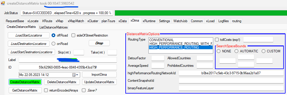

and another mega distance matrix based on 62'434 pairwise different (x,y) computed with an HPR based on
- car, no further truck attributes
- geographic restriction: allowed countries = ["IT"]
took me 10:48 minutes and occupies 29GB memory for it's 3'898'004'356 relations...
