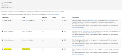

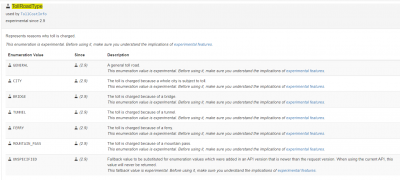

Thank you very much for the code snippet. I can now calculate the toll costs so far... but in XS1 I was able to receive the “TollType”.
With the TollType I was able to filter to “NATIONALTOLL” and “CITYTOLL” and calculate the toll without any special charges (e.g. the Mont Blanc Tunnel).
Is there a possibility to filter these costs in XS2?
(Since 2.9 experimental the “TollRoadType” exists. Will that be the equivalent of XS1 “TollType”?)
Alex

look at https://xserver2-europe-eu-test.cloud.p ... llRoadType !

Hmm... I have read that, so I guess that means: "Yes, it is the equivalent". (but experimental) :lol:
Unfortunately the feature is part of the “Toll”, which data (for Europe) is not available at the moment.
Alex
