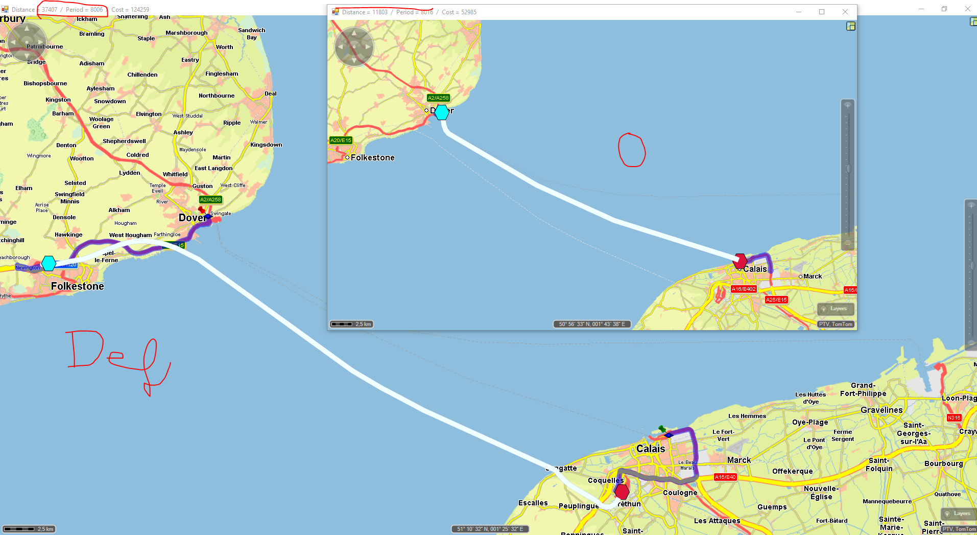

biro.daniel
- Posts: 41
- Joined: Tue Aug 23, 2016 8:08 am
Re: Block Ferrys
Dear Bernd,
I have the same issue as Max: when routing between Calais and Dover (50.968637698, 1.873768495; 51.131455905, 1.3286909207), the GB-FR direction is all good (it uses the ferry), however the opposite direction (FR-GB) uses the Euro tunnel, and I cannot force to use the ferry in this case too. To tell the truth, I was not able to make the routing use the ferry instead of the Euro tunnel in any cases, when tried to relocate the FR coordinates.
Currently, we are looking for a solution where we can use only coordinates (and not FerryIds) for routing requests. Do you have an idea what is the issue here? Does the opposite direction have different parameters (eg. cost) that would make prefer the tunnel?
Thank you in advance,
Daniel
Daniel
Max Beermann wrote:Hi Bernd,
oh that looks interesting > but I think i have to improve my xServer-skills for that.
Maybe it is getting easier for me:
I want to make sure, that - in case of a GB-destination - the ferry from Calais to Dover will be used.
I could avoid all the surrounding ferrys > but why not prefer the ferry from Calais to Dover(?):
My thought is the following, but the parameters are wrong and maybe finally ArrayOfExceptionPath is not the right one to pic:
If Start <> "GB" and Destination = "GB" then
<ArrayOfExceptionPath_4 xmlns:xsi="http://www.w3.org/2001/XMLSchema-instance" > <ExceptionPath absTimeMalus="0" binaryPathDesc="" extSegments="" relMalus="-99" street=" Ferry Calais "xmlns="http://xroute.xserver.ptvag.com"> <wrappedNodes xsi:nil="true" /> <polyline xsi:nil="true" /> </ExceptionPath> </ArrayOfExceptionPath_4>
Maybe you know what I mean/what to do?
Thanks for all your kind help!
Max
- Posts: 3001
Re: Block Ferrys
Hello Daniel,
maybe the following description helps:
Among other approaches the motivation for a different track could be
- block elements on the unwanted route (define penalties AKA malus)
- make elements of the desired route more attractive (reduce their costs)
I created a simple routing from FR to GB using your coordinates and it took the tunnel.
By setting the OPTIMIZATION to an extreme value of "0" I encountered the change of the route: Let's have a look at the tunnel's own values (period, to be more precise):
"Calais - Dover" requires about 7140 seconds (about 120mins)
"the Tunnel" requires 5400 seconds (=90min)
I then played with optimization:
in my environment the behaviour switches between 73% and 75%.
I recommend that we have a 1:1 session to discuss how to approach this.
