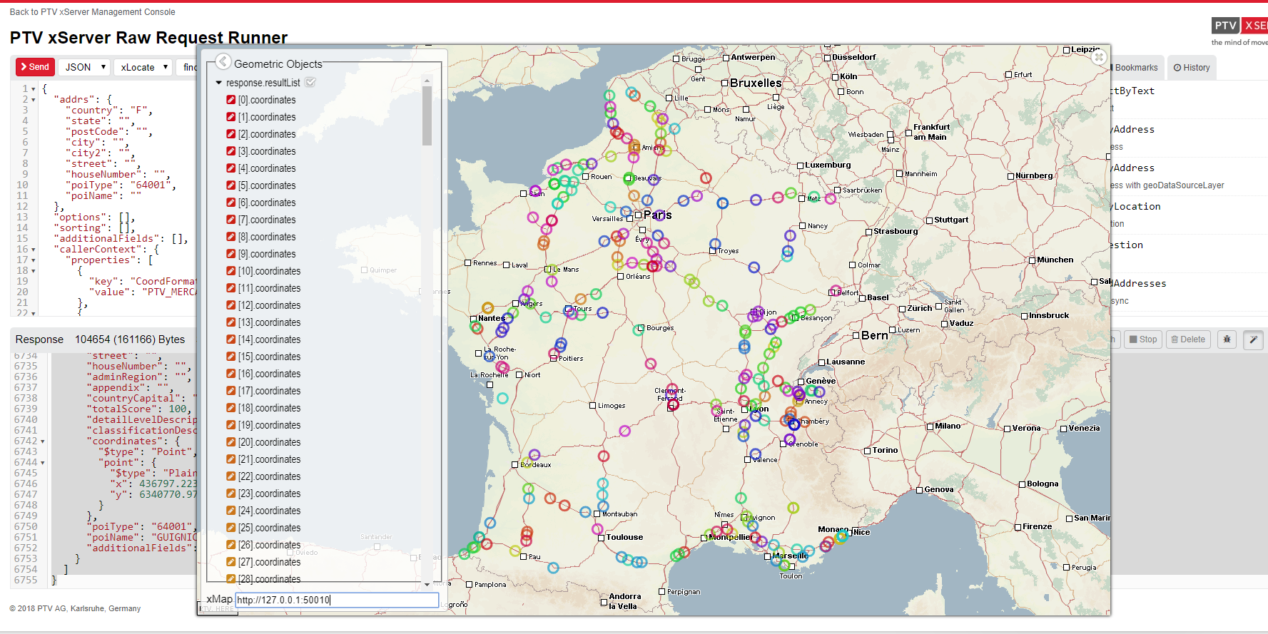

Within the xLocate 1 interface we offer the POI search where you can limit hits to specific POI types, e.g. TollLocations:
https://xserver.ptvgroup.com/fileadmin/ ... _Types.htm
But before I can give you a proper direction I'd like to understand your expectation towards the info you want to gather:
What is you understanding of a "toll object"?
sample output for the request
  "addrs": {
    "country": "F",
    "state": "",
    "postCode": "",
    "city": "",
    "city2": "",
    "street": "",
    "houseNumber": "",
    "poiType": "64001",
    "poiName": ""
  "options": [],
  "sorting": [],
  "additionalFields": [],
  "callerContext": {
    "properties": [
        "key": "CoordFormat",
        "value": "PTV_MERCATOR"
        "key": "Profile",
        "value": "default"

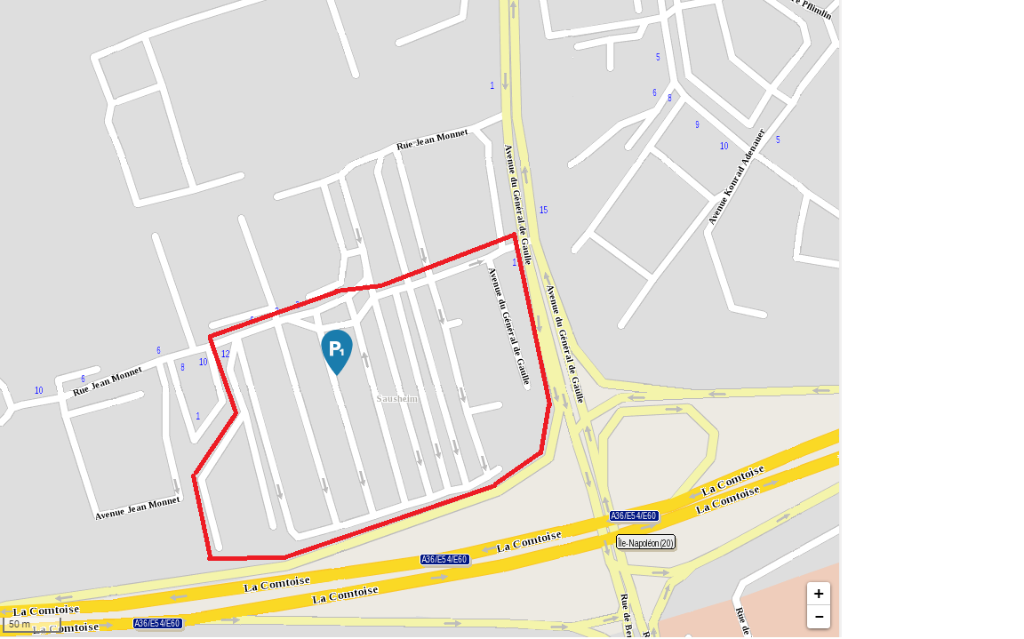

Our understanding of TollObjects currently consist of parking lots, ferries, gas stations, etc. So thus, what we call TollObject is a subset of the POIs you have sent us in your answer.
What we intend to do with them is assign a certain area to each of these POIs, just as you can see in the attached picture. Our goal is to more accurately pinpoint the locations of event recognition.
In this example, the POI in question is represented by the P1 marker and the polygon, which is the actual area of the parking lot is highlighted in red.
The information we are seeking is the red polygon. Therefore, the question is whether you have this information readily available in some accessible way? And if not, is there a tool you can provide us to record them manually?

Currently we recognize when a long-haul truck stops (and stays there for an extended period of time) in the vicinity of the POI, but however our systems do not explicitly match the given stop to the predetermined task (in this case let's say a parking). Thus, if we had the table you mentioned, we would be able to determine whether the truck stopped in the geometry of the parking lot, or if it is just outside of it and therefore the event classifies as a wrong parking (when the truck stops at not the predetermined parking lot, but farther away, where for instance it could be robbed).
Therefore we would like to implement the geometry of POIs in our workflow in this step, to be able to more accurately recognize whether the truck is inside the borders of a POI or not, and thus limit the recognition of false wrong parking events.
