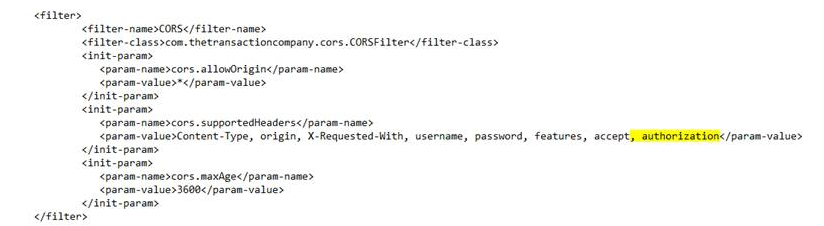

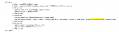

SAP UI5 defines some http headers which must be supported by the application to get CORS worked. In our case, header "authorization" was missing.
We added it in xroute/webapps/xroute/WEB-IN/web.xml. Now it works fine
