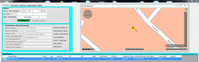

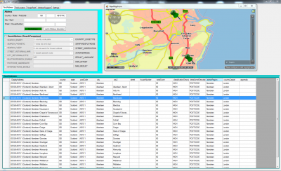

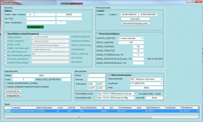

As you can see the search for 6 leading characters “AB101A” returns several hits with extended postcodes (see DetailLevelDescription). Those are all the postcodes and their reference points that start with AB101A. Very important: There is no AB101AC

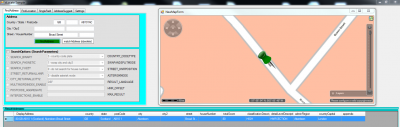

AB101AA (existing postcode) - UNIQUE hit with EXTPOSTCODE.<br />As the code AB101AA exists in the extended data we can find a perfect match and this is returned as a UNIQUE result on EXTPOSTCODE level. (A street nearby is Broad Street.)

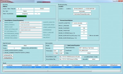

AB101AC (non existing postcode) - Multiple hits with POSTCODE. <br />As the code AB101AC does not exist in the extended data we fall back to the basic data. This is why you can also see the district names in the result list and the detail level is now POSTCODE (and no longer EXTPOSTCODE).

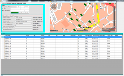

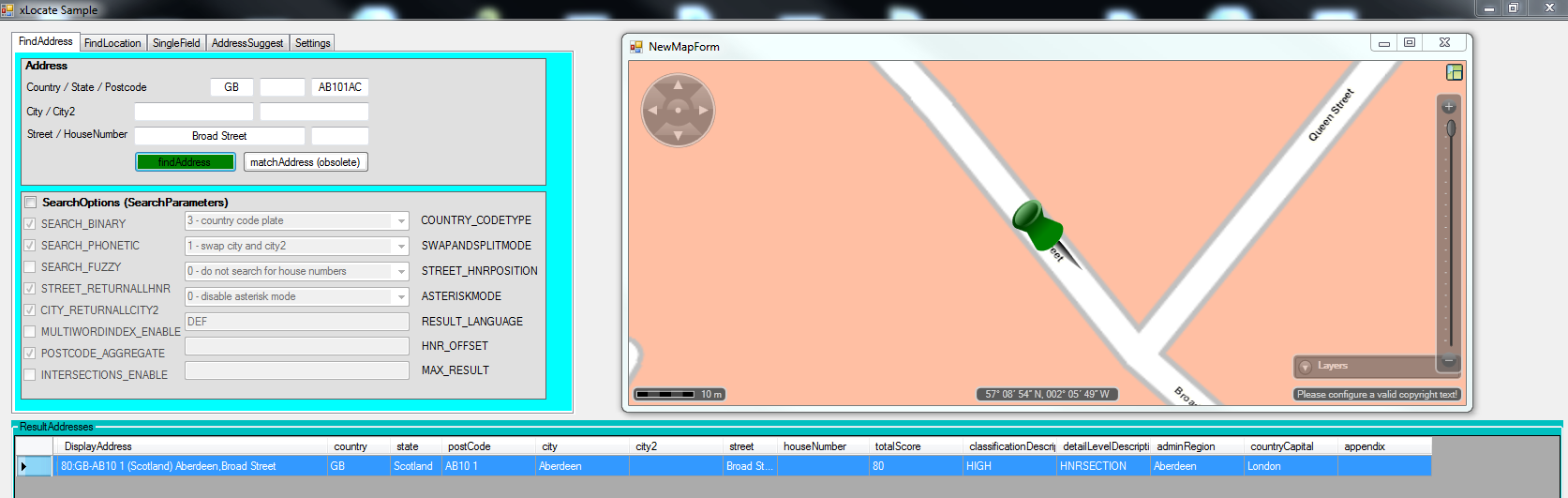

AB101AC with BROAD STREET - UNIQUE hit even more detailed! <br />As we do not find a perfect match during the EXTENDED search we fall back to the standard data. In the standard search we use postcode AB101 and street name Broad Street and we are able to find a good result  DetailLevel is even HNRSECTION

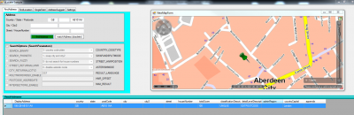

AB101AA with BROAD STREET - UNIQUE hit at EXTPOSTCODE level. <br />Once more we are successfully looking for the extended postcode and this is why we return the UNIQUE hit on EXTPOSTCODE level.
