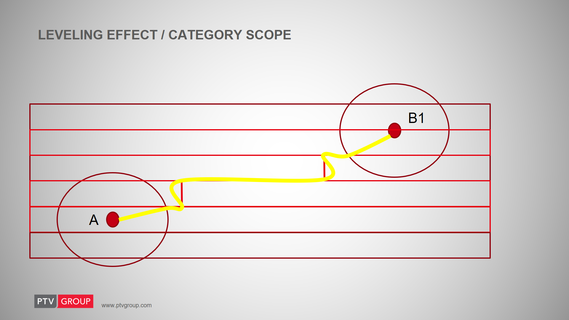

Imagine the calculation with just the two waypoints A and B1. In the proximity of both waypoints the temporary data structures used to calculate the track contain a detailed streetnetwork but outside the circles the temporary network is based on NC0, NC1, NC2 only. SO outside the cirles the vehicle moves on higher street categories. The  yellow polygon shows the geometry of the result track

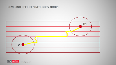

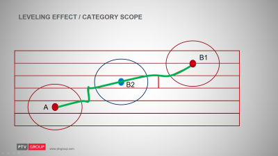

By adding the B2 and it's proximity area the temporary structures are different from those used in the previous scenario and therefor the algorithm finds additional opportunities to get from A to B1. The solution is the greeen line.

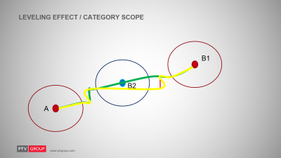

This image just shows both solutions at one glance. As you can see the green track is a bit shorter.
To avoid such a behaviour you could ether set the category scope of all NC's to -1, but keep in mind:
  • bad impact on performance because many more segments have to be evaluated
  • maybe tracks returned you don't want to (would you really want to leave the highway in the middle of a 600km route just to save 1-2 km of total distance?)
