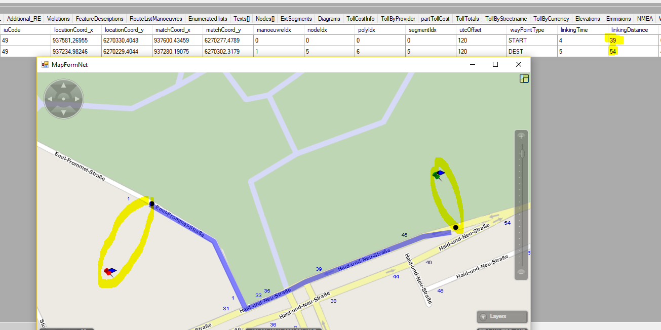

Lets say I make an ExtendedRoute calculation with the following points:
"waypoints": [
      { "latitude": 46.918599, "longitude": 18.111492 },
      { "latitude": 48.430225, "longitude": 12.392042 }
In the answer I receive the following result:
(Of course the values might differ with other profiles etc.)
Route.Info.Distance = 636621
Route.Info.Time = 21988
But if sum the Route.WrappedCountryInfos.PartRouteInfo.Distances/Durations (so the separated country relevant values) the values differ (somethimes the difference is more significant):
Sum: 636619
{ "country": "HU", "distance": 152245 },
{ "country": "SI", "distance": 91568 },
{ "country": "AT", "distance": 332234 },
{ "country": "DE", "distance": 60572 }
Sum: 21987
{ "country": "HU", "duration": 4629 },
{ "country": "SI", "duration": 3065 },
{ "country": "AT", "duration": 11435 },
{ "country": "DE", "duration": 2858 }
What can cause these differences?
My guess: The distance between the provided point and the segment where the point is linked to does not take part in the country based summary. Is that the correct guess?
Posts: 3053
Re: Aggregated values differ in wrappedCountryInfos
Hello Zsolt,
as far as I know your explanation is 100% correct:
The total distance is based on the NC_0, NC_1, ...NC_7 + linking distances.
The national contribution only considers the distances on the NC_0, ...NC_7.
The picture shows the LINKING DISTANCES (39+54 meters).
and the difference between the "street only distances"
KZsolt
Posts: 51
Joined: Fri Oct 03, 2014 1:19 pm
Post by KZsolt »
Hey!
Awesome!
Thanks Bernd!
