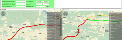

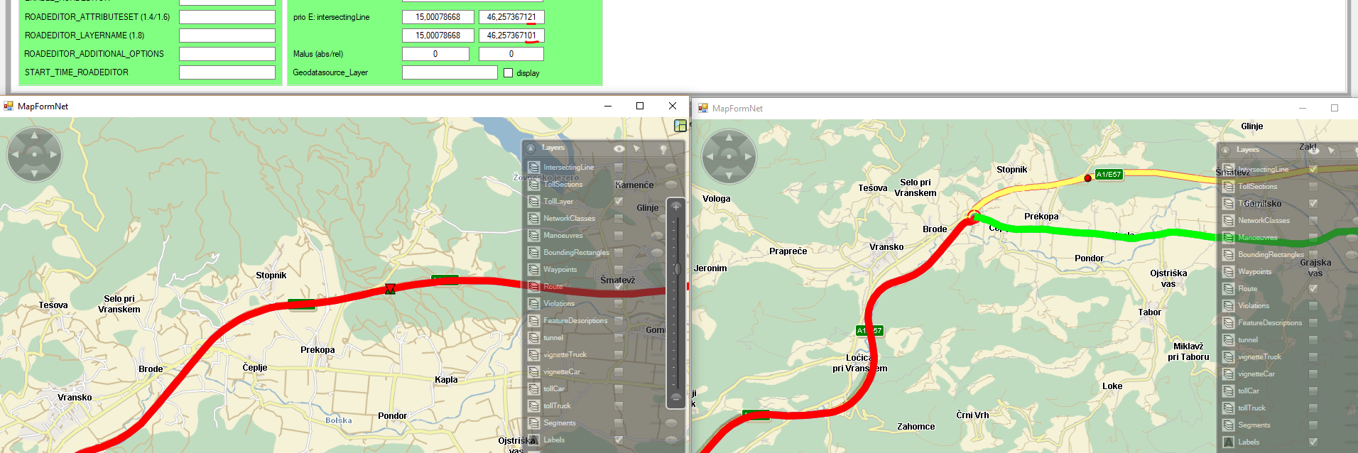

As for my problem... I recently encountered some troubles avoiding toll sections that are represented by one coordinate.
I started off with using the approach you suggested, it worked on most cases, but sometimes the path would still run through the intersecting line (more accurately point, since I used two identical points, just like you suggested). So instead of only using the start coordinate of the toll section, I identified all the coordinates that belong to the toll section and created an array of exception paths (each entry in the array corresponds to one coordinate of the toll section).
This approach works flawlessly, except when there are toll sections represented only by one coordinate, then the newly calculated path does not take into the account the intersecting "point".
Here is an example XML request using a route that runs on Slovenian highways (I've noticed that some toll sections in Slovenia are represented only by one coordinate. I have occasionally noticed the same with some tunnels while testing.)
So is there maybe a different way of doing this, or am I missing something?
Thank you again in advance for your help!
Rok

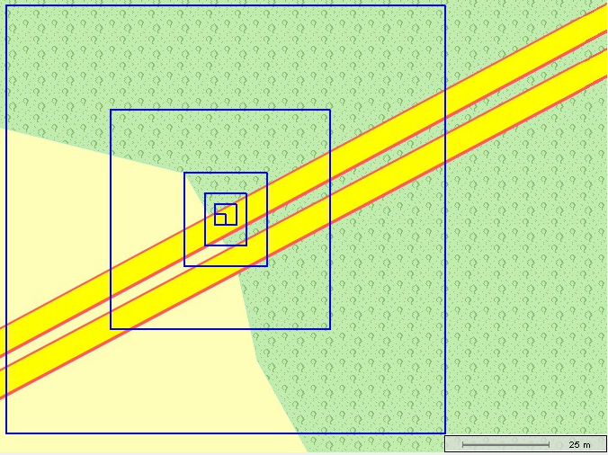

How about this approach:
Fake a line / or a cross / rectangle which is created by using a small deviation based on small double values...
Worked fine with your sample (where a single line was sufficient due to the obvious structure of the "west to east" polygon...
- Posts: 2894
Re: Calculate route around a specific toll section
Maybe you could also use some kind of a small rectangle.
