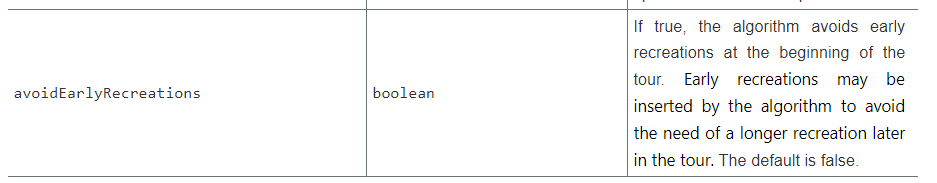

Also, since the 1.24.0.3 release this parameter is available in the interface on the planningparams so you do not have to adjust your server side configuration. See also:
https://xserver.ptvgroup.com/fileadmin/ ... ningParams
