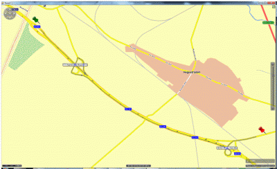

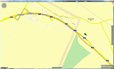

I face an interesting problem that I can't solve on my own:
As you can see on the attached picture I have a defined waypoint next to a border (green flag) , and the NEXT_SEGMENT or AUTO_LINKING links that point to the START position. The problem comes from that new position because it's in a different country which is excluded during the planning. As a result PTV can not plan that route.
The easy solution could come from the heading values but they are not defined in that case. My first idea was to increase the search range for the matching, but it had no effect. As I see PTV doesn't try to find a new waypoint after he find 1 which is valid, even if he can't plan a route with it. Is that correct?
Do you have any suggestions how can the matched point be placed in the same country as the original point?

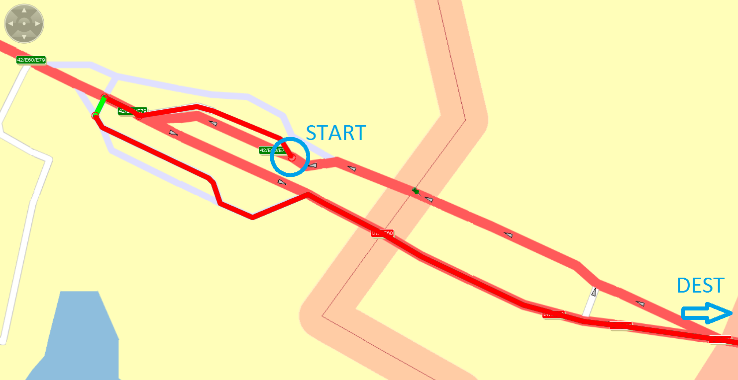

Re: Routing countries
With the feedback above into consideration: Assuming that you always select the point on the border I would go for NEXT_NODE linking and turn one way restrictions into a heavy avoidance. The route will then be "wrong" at the start since it drives back one the wrong highway lane until the first chance to switch lanes again. It migth not be perfect but better then nothing.
xRoute Profile in the online manual:
http://xserver.ptvgroup.com/fileadmin/f ... e%7C_____0
Look for: Routing / Course / BasicDataRules / Blockings / @oppositeDirectionInOneWayRoadMalus and set this attribute to 2500 .
Disclaimer: I haven't been able to work this out in an actual test so it "works in theory". I would be interested to see if this helps you.

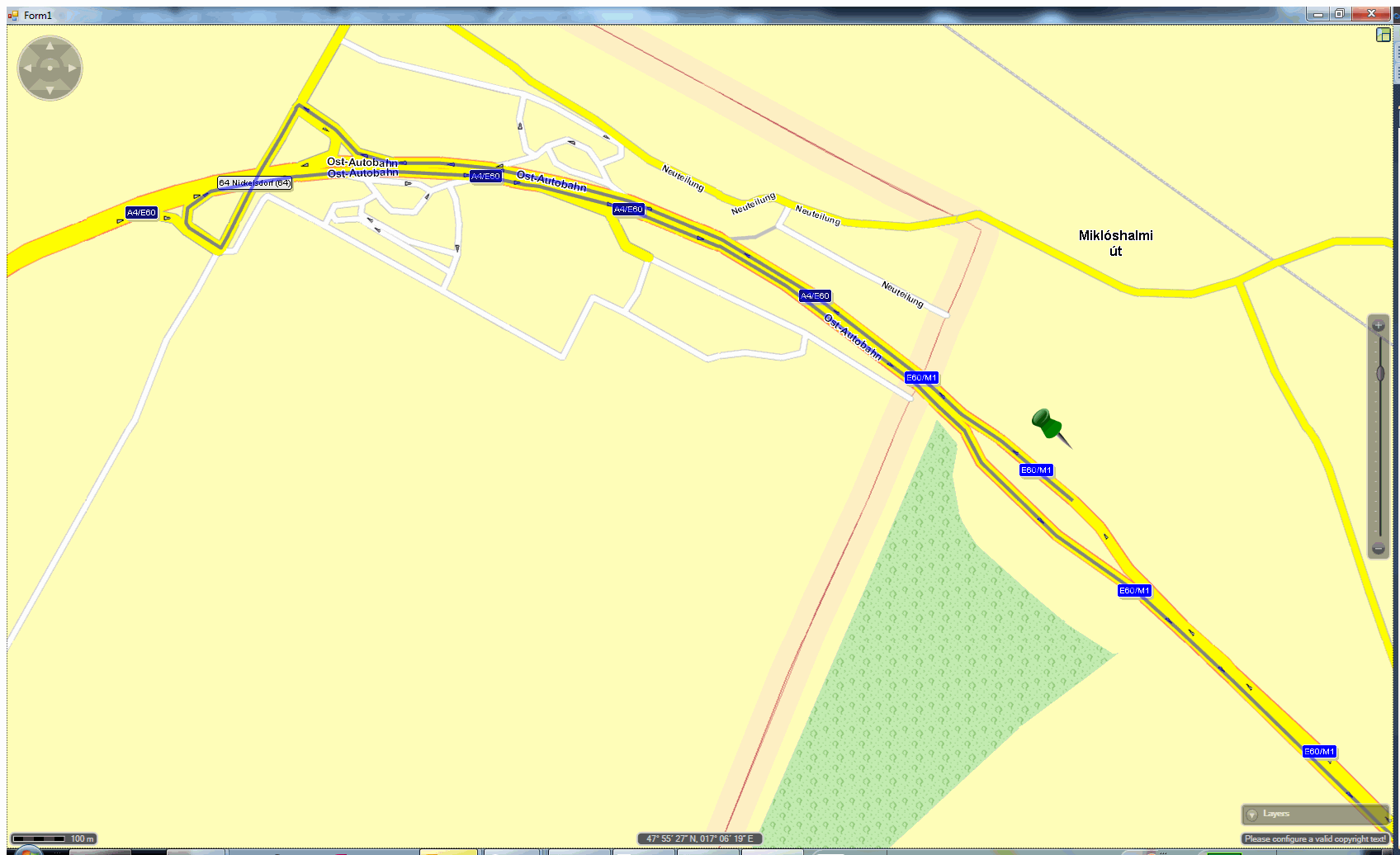

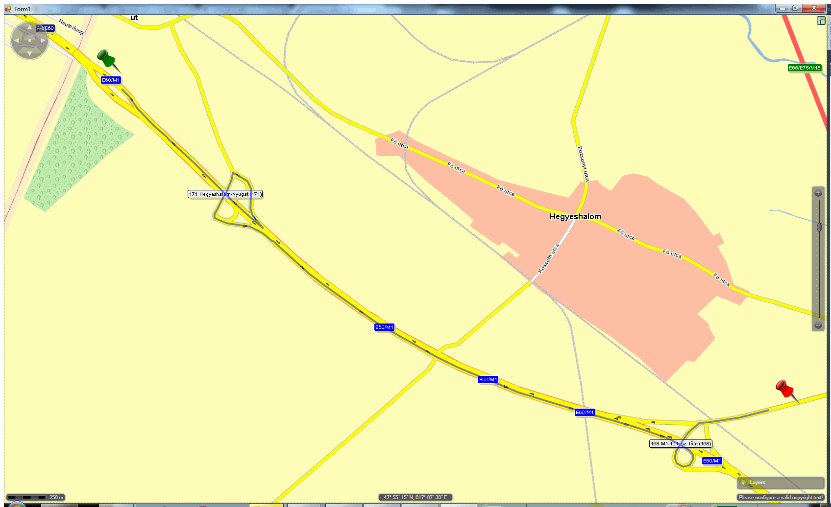

Hello K.Zsolt, Joost,
I made a test - seems to work, but: I do not believe this is what you want to have. See my attached screenshots.
The snippet looks like this:
This is the complete request (ok, a little bit overheady
 ) snippet in line 47
Regards Bernd
