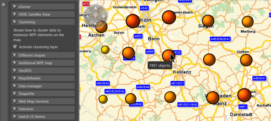

how about this example from the Demo center? Usually an aggregation of 20.000 objects into various grouped icons is a valid approach.
XServer.NET Demo Center<br />Usecase Clustering (maps)
Or would you really like to see 20.000 different objects on the same map?

Generally that's a tough problem, and there's no simple answer for it. But you can classify the solutions bythese three categories:
  • Use POI-Clustering
    This handles the problem by reducing the total count of elements which have to be created. But this may be not appropriate for every use case.
  • Optimize the Shape-Layer Rendering
    See https://github.com/ptv-logistics/xserve ... erformance for examples how this affects the performance, especially for VDI (= virtual desktop infrastructure) environments.
  • Use a custom GDI Renderer
    This doesn't create individual wpf elements for every icon, but renders a single image for all icons, and overlays that on the map. We have a sample that uses SharpMap (https://sharpmap.codeplex.com/) for rendering the objects, see https://github.com/ptv-logistics/SharpMap.Widgets. A caveat is that you have to implement the hit-testing (e.g. for clicking) by yourself. A nice benefit is that this code can also be reused for web applications.
