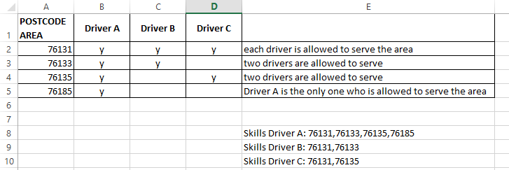

Posts: 2798
Re: USECASE service technicians
thanks for your feedback but I don't think the categories can help here as a RESOURCE would belong to exactly one category but in our usecase the RESOURCE is allowed to serve one or more areas.
Better to visualize it this way?
Regards

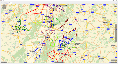

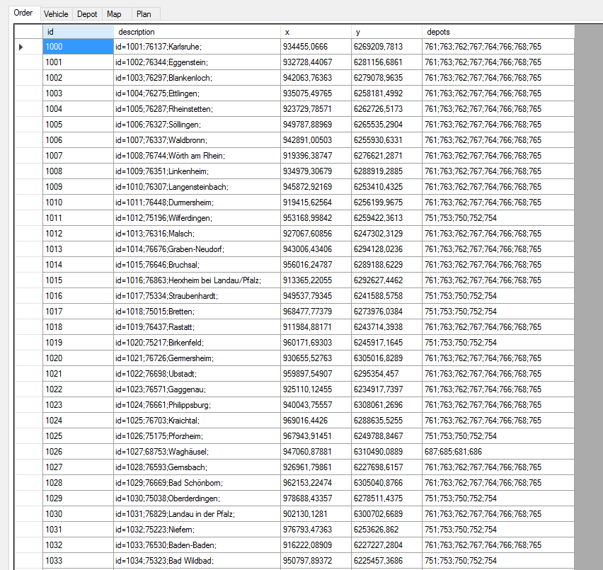

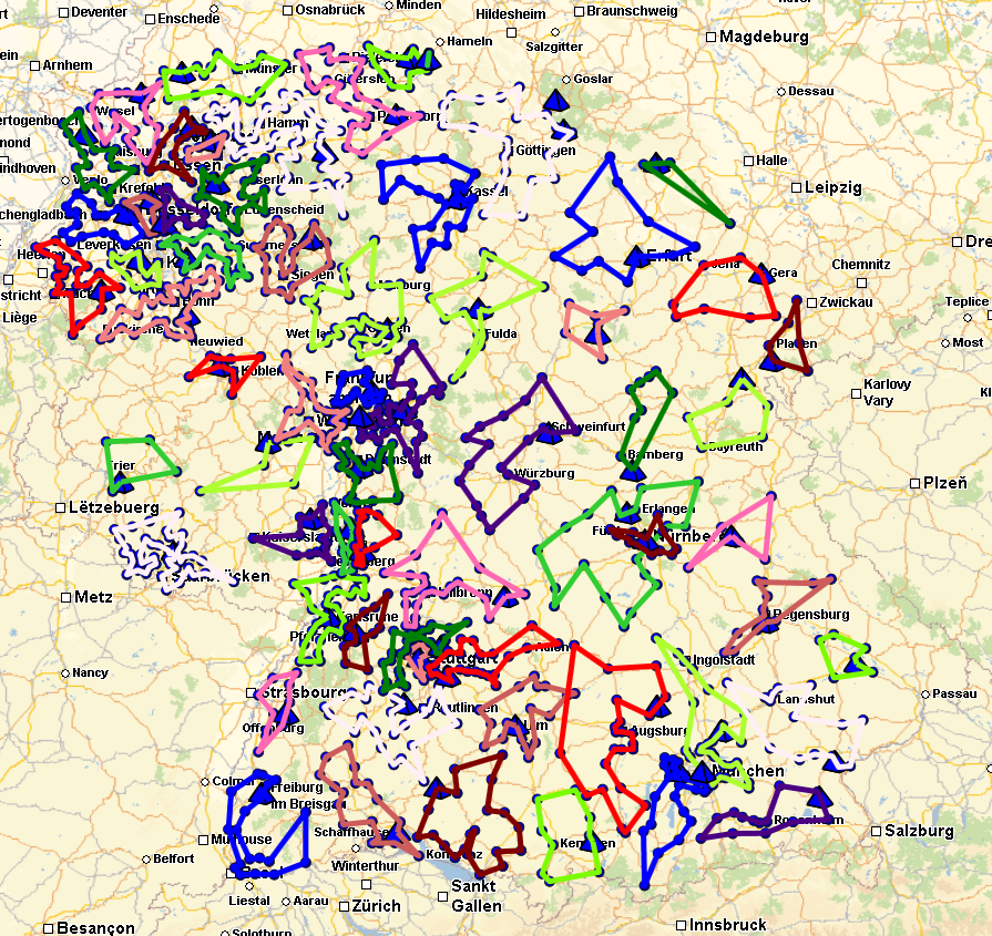

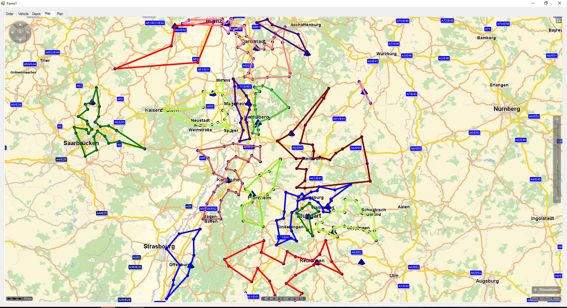

Posts: 2798
We approached this via the depots now:
Each ServiceTechnician is modelled as his own depot and then we specify a list of potential depots that could serve customer xy.
Codesamplescreen
Codesamplescreen
Looks promising - have to check this with bigger values...
Each order is served by one or more depots (=service technicians).
Looks good...!
Looks good...!
